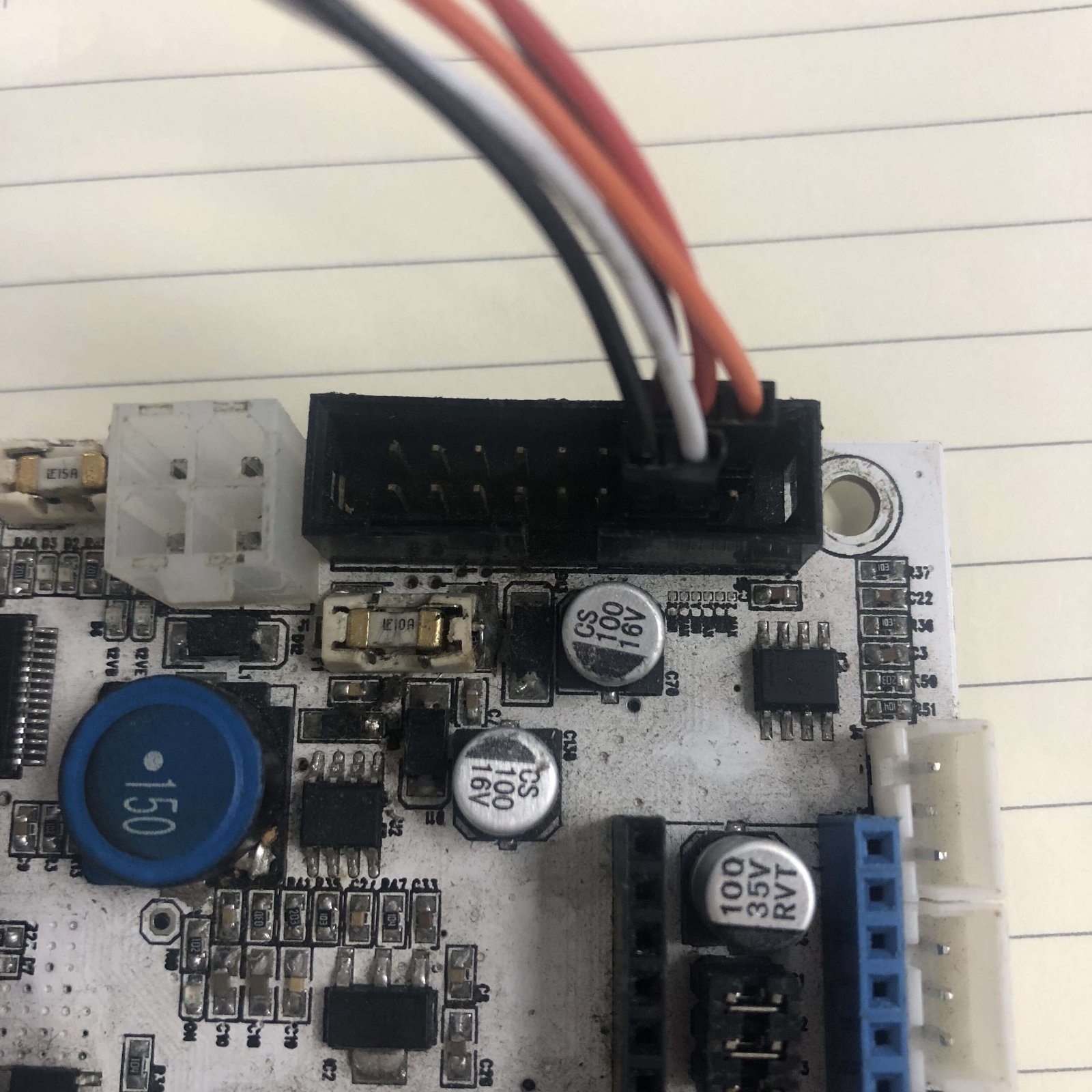

Hello everyone!
I have the MC2 and it has the GT2560 Rev B control board. Is it possible to add a BLTouch to this printer? Will I have to do anything with the firmware to turn auto leveling on?
Thanks to all who reply!

It's possible, you can try it.
In their user manual, there might be an introductions of firmware setting.
GT2560 RevB+3D Touch.jpg (323.11 KiB) Viewed 16550 times

Easy... the orange one is the signal one. As I know red and orange here must be swaped.

Wolle82 wrote: Thu Nov 22, 2018 10:32 pm Easy... the orange one is the signal one. As I know red and orange here must be swaped.
Yes, you are correct! And sorry, I should double check.
