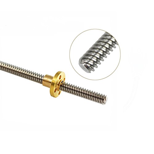

I don't know why but when I go to print something, the print head moves into position but is about 7mm above the print bed, even after leveling. can someone please help.
Gingko
Posts: 230
Re: raising on print
Post by Gingko »
Are your rods looks like this?
If yes, then they should have different steps, send Gcode"M92 Z400" and then send"M500" through slicer software to change it.

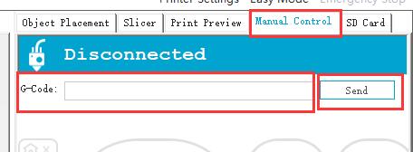

Can repetier host succefully connect to your printer?
If yes, then you can send this two gcode through manual control->G-Code.
M92 Z400: change the setp/mm for Z-axis
M500: saving to EEPROM
