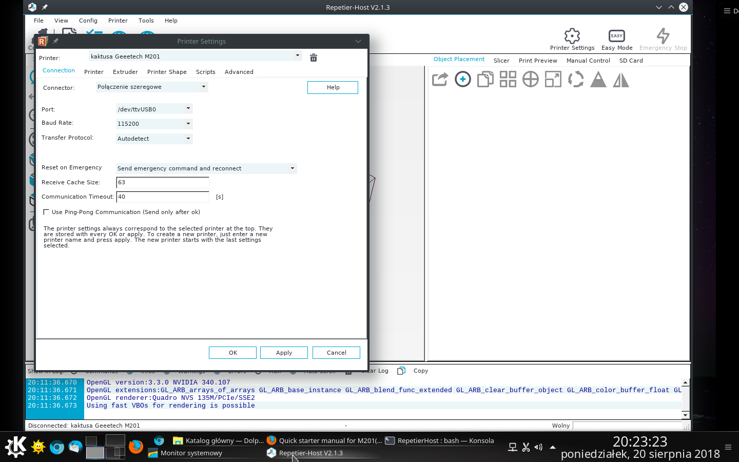

The test script showed that my user belongs to a group that has access to serial devices. :D
And the need to search for additional packages for installation...
Once we get through the shortcomings of the test script, you can enjoy the working program.
Don't forget to add your user to a dialout group when you haven't done it before.
After running Repetier-Host we carry out its standard configuration.
