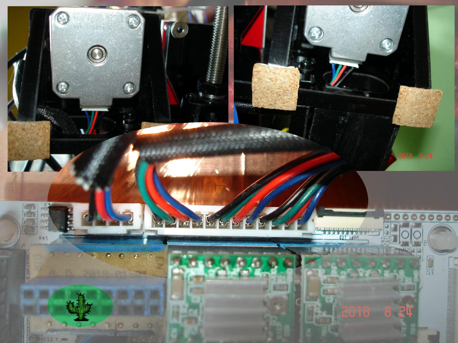

If you are currently building your printer or upgrading, the picture below may be helpful to you.
It shows how the Z axis motors are connected. And the order in which the cables are laid in the motor connector and controller board connector.
The other motors have the same wiring arrangement in the connectors.
This connection guarantees the proper operation of the stepper motors.
