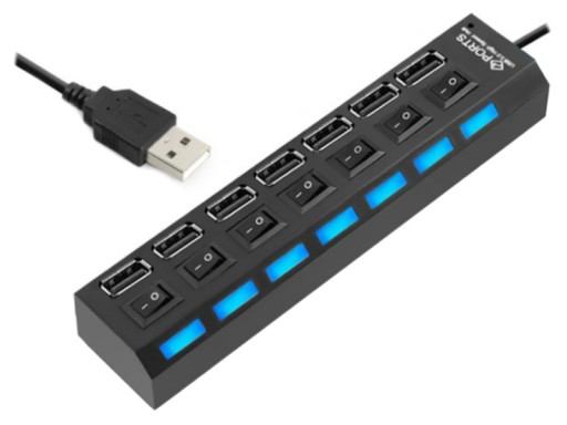

Perhaps a good way around the problem is to use an usb hub with a switch.
