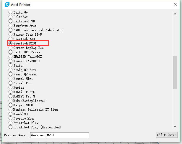

Are you can't find Geeetech M201 on Cura?
Don't worry
Refer to these:
1.Download Cura Profile for M201.zip(the .json file for M201)

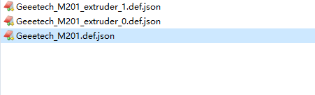

2. Unzip the zip file then you will get 3 files

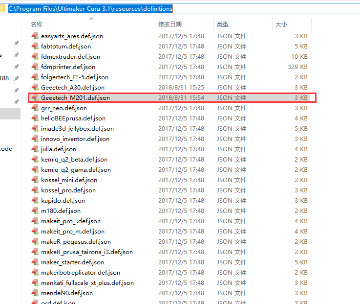

3.Copy "Geeetech_M201.def.json" to the
Cura installation directory
Default:
C:\Program Files\Ultimaker Cura 3.1\resources\definitions
4.Copy "Geeetech_M201_extruder_0.def.json" and "Geeetech_M201_extruder_1.def.json"
to"C:\Program Files\Ultimaker Cura 3.1\resources\extruders"
5.Done!Enjoy it!
