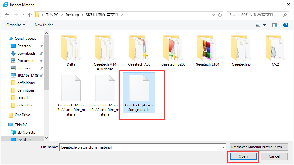

Download the PLA filament profile for A30
Geeetech-pla.xml.zip
(932 Bytes) Downloaded 2332 times

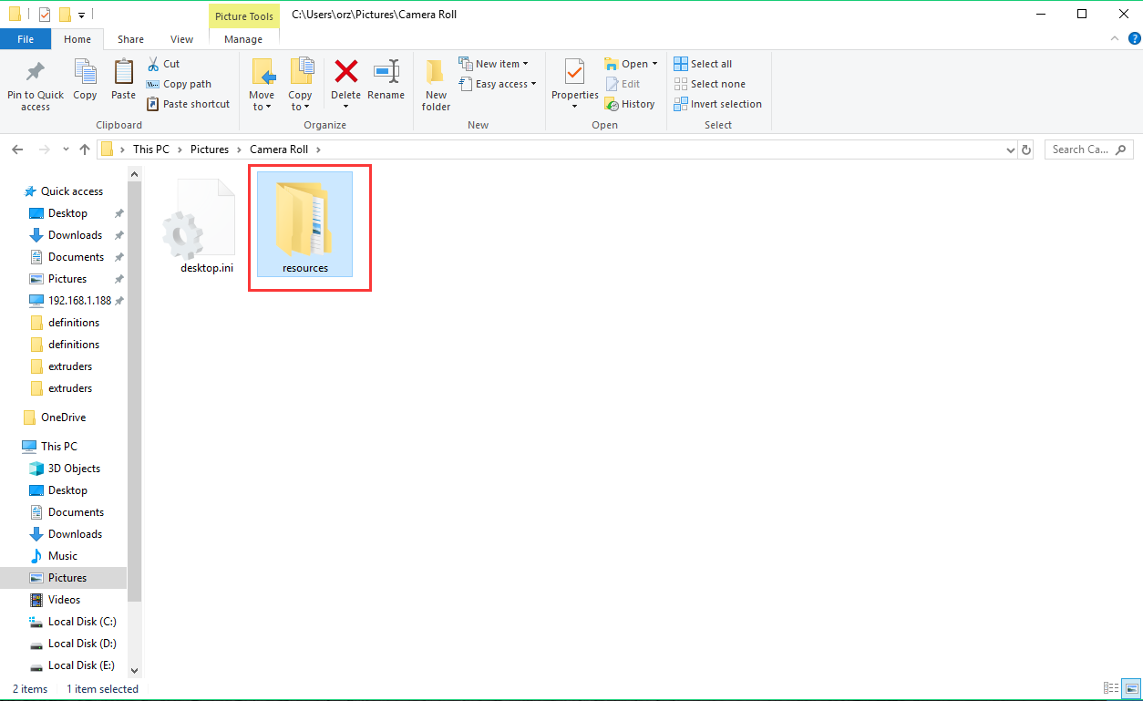

2. Unzip the zip file then you will get "resources"folder

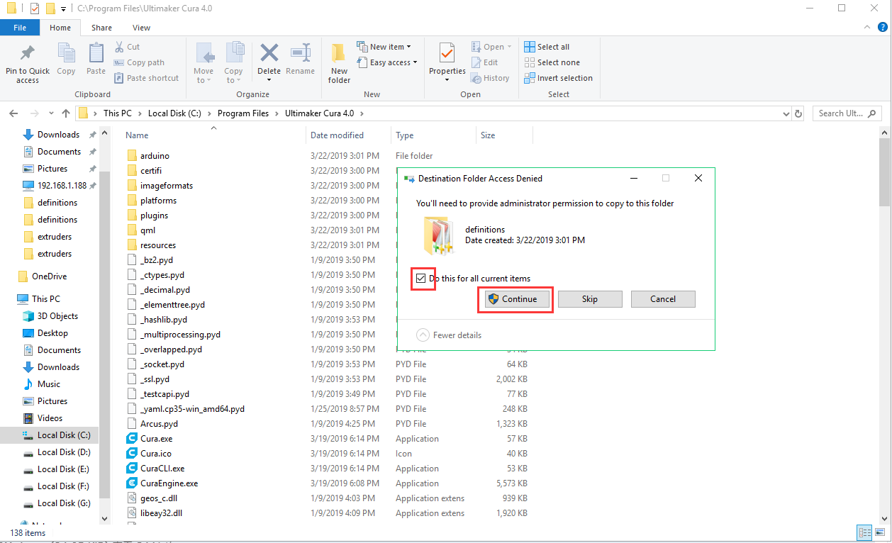

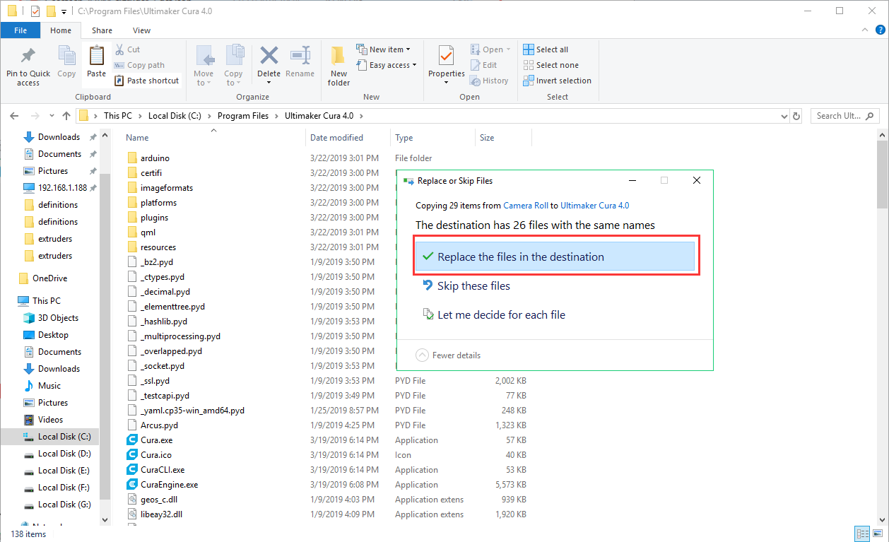

3.Copy "resources" to the
Cura installation directory
Default:
C:\Program Files\Ultimaker Cura 4.0

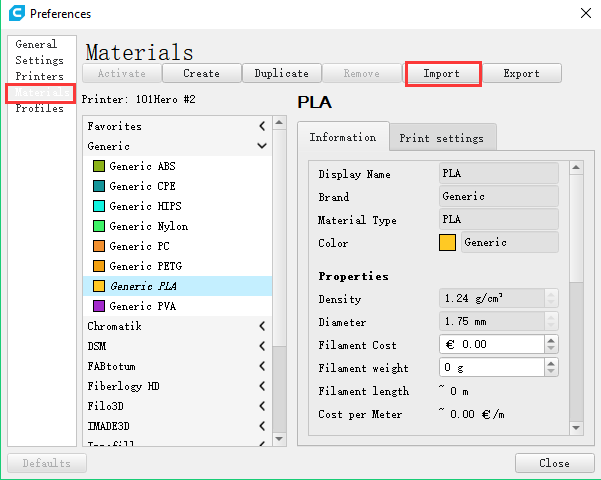

4.Import filament profile
5.Done!Enjoy it!

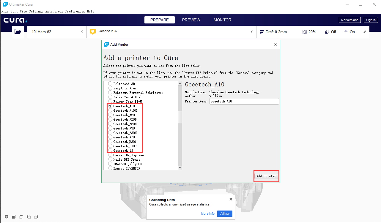

A30 and A30Pro printer are not in the list. I tried both with Cura 4.6.2 and 4.7.1
If I choose A30M and disable one extruder, the printer's display shows something like "gcode is impossible to open".
Note: I have an A30pro, I would prefer to find the A30pro in the list.
Thank you
Marcellus
Posts: 14
Joined: Tue Jul 02, 2019 11:25 pm
Re: How to add the printer Geeetech A30 to Cura
Post by Marcellus »
Hello
Dont look for Geetech! Look for Shenzhen Getech Technology, there you will find the A30...
Greets
