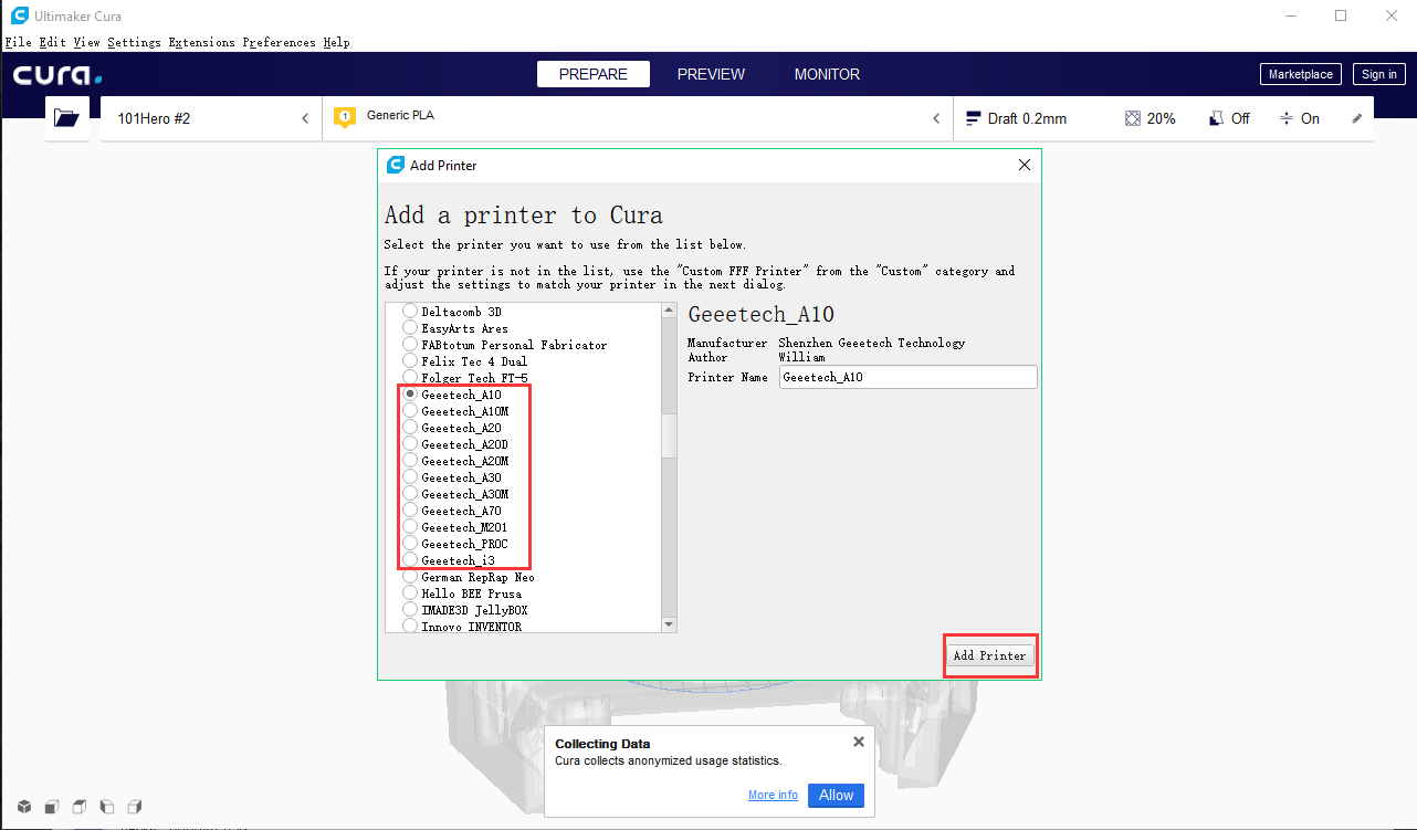

Hi guys! :o
Are you can't find Geeetech A10 on Cura?
Don't worry
Refer to these:
------------------------------ :D --------------------------------------------------
Update:Thanks for @vert's suggestions.
1. We added the G29 for the start code
We added the "G1 Y230 F6000" for the end code( 2019/1/7)
2. We attached the PLA filament profile for Multi_mixer printer(2019/1/23)
3. We set the default filament diameter to 1.75mm and it can work with Cura 4.0(2019/4/7)
4.Thanks for @LisaE‘s suggestions.The profile updated.(2019.4.17)
5. Deleted the "Heating gcode for nozzle/hotbed"in"start code".Added the meshes file.(2019.4.24)
1.Download Profile for Geeetech 3Dprinter
Cura4.0 resources.zip
(158.48 KiB) Downloaded 7385 times
Download the PLA filament profile for A30
Geeetech PLA_1.xml.zip
(930 Bytes) Downloaded 4689 times

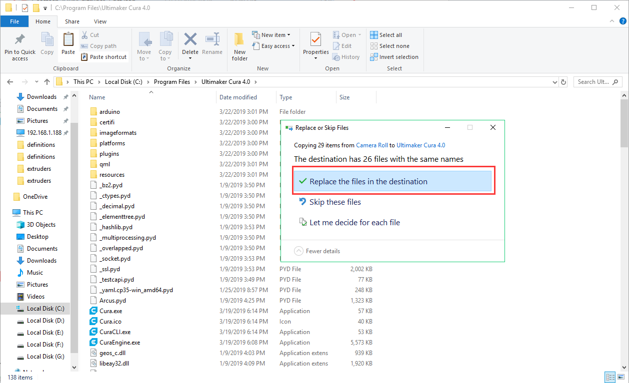

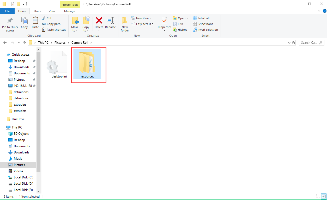

2. Unzip the zip file then you will get "resources"folder

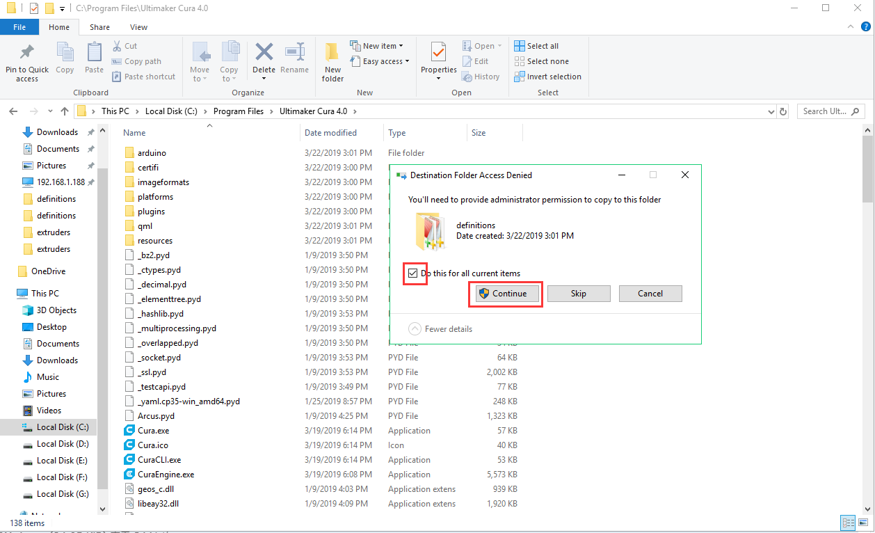

3.Copy "resources" to the
Cura installation directory
Default:
C:\Program Files\Ultimaker Cura 4.0

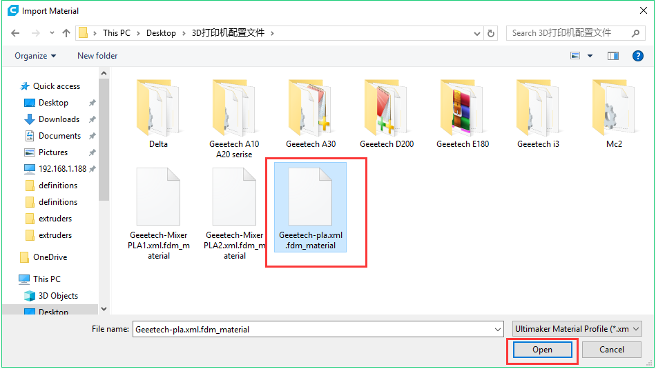

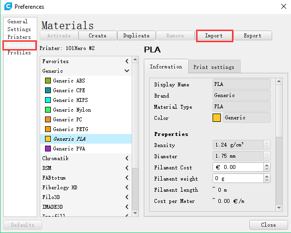

4.Import filament profile
5.Done!Enjoy it!
