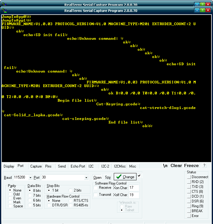

Hello
You can try to run the console on your computer, and then turn on the printer power. The printer sends an identification string each time it is started.
You will read it from the console.
In my case it looks like this:
