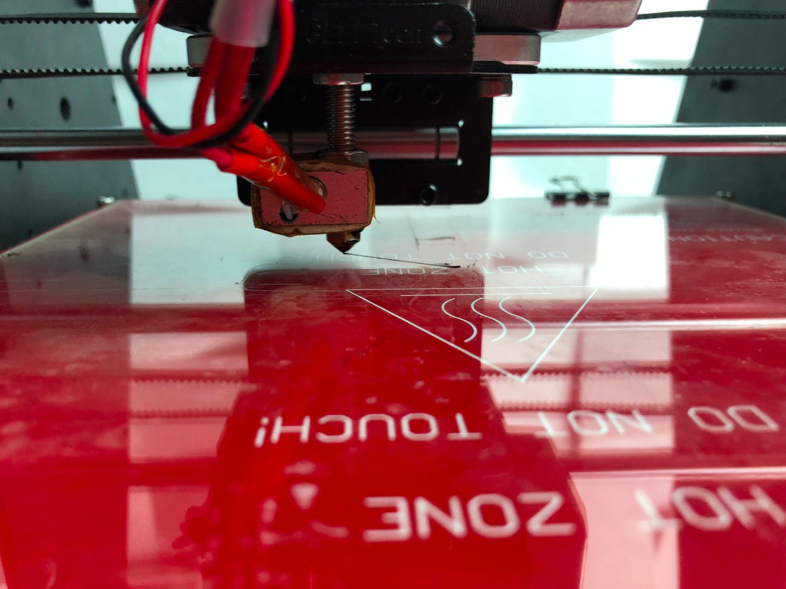

How did you calibrate the z axis?
Going by the pics, your first layer height is 0.3 but it looks like your nozzle is too high from the bed.

Hi Keyser187,
Actually i have did calibrate with piece of paper.. and when i set home, the nozzel be perfect level with bed. But the problem when starting printing it will start with 0.3! And that really big gaps between nozzle and bad :roll:

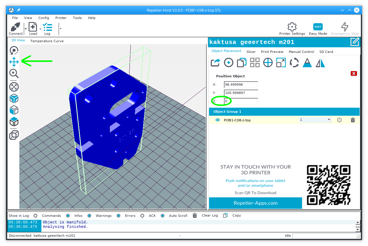

Did you check the position of the model in Slicer?

_kaktus_
Posts: 1259
Location: PL
Contact:
Re: Z axis printing problem
Post by _kaktus_ »
For example, this way:
:D

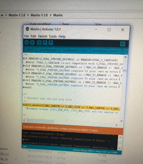

also if you have Manual Bed Leveling on, try turning that off and try again (you probably wont have this feature unless you have updated firmware to marlin 1.1.8)

hello keyser187,
I have try upload marlin 1.1.8 but! get error!? :roll: :idea:

keyser187
Posts: 28
Joined: Mon Jan 22, 2018 9:28 am
Post by keyser187 »
viewtopic.php?f=82&t=61011
Try this 1 that I got working on my pro w
Also update arduino version to upload or it dosnt work
