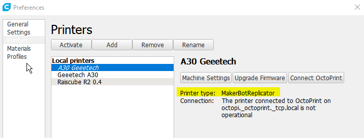

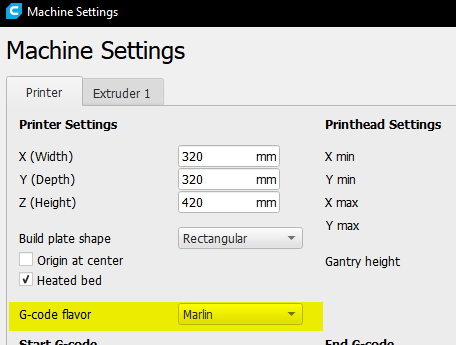

Look to my experience:
http://www.geeetech.com/forum/viewtopic ... 770#p86812
For your convenience here the important settings:
2018-10-25 12_25_55-Preferences.png (13.1 KiB) Viewed 14573 times
2018-10-25 12_26_41-Machine Settings.png (11.1 KiB) Viewed 14573 times
