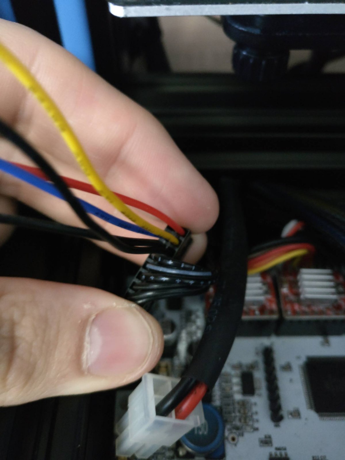

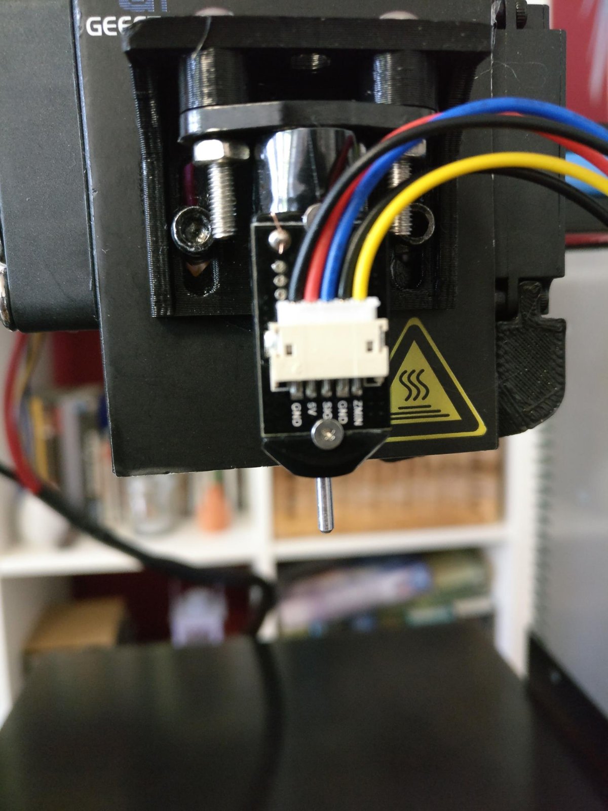

Moin,
I post my configuration here. Please note that the wiring in the picture is wrong - you need to switch the yellow and blue wire. Together with my firmware it should work.
Hope it will help you.

Re: Marlin firmware with BLTouch at ZMin
Why do you post wrong pictures?
Because I made these pictures before I got it working. Just switch the zmin (yellow) and the signal (blue) wire in the connector and it should work.
