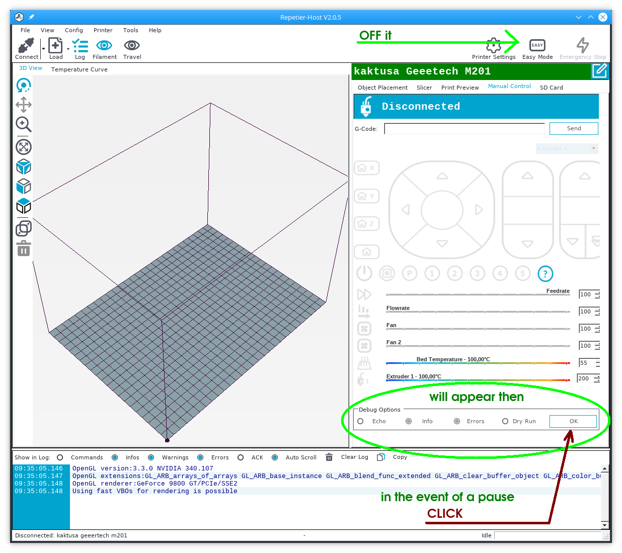

I expect that from time to time you are tormented by unexpected pauses during printing. :?
The result is that the printer dies without movement during printing, with the head lowered, and the hot end melts the model created. :cry:
Sometimes this state lasts longer and sometimes shorter. It is not known what it depends on. :roll:
This state of affairs accompanied me quite often when the printer was newly built.
For today, it happens to me quite rarely, but still.
I expected this phenomenon to be the result of transmission errors, but I wasn't 100% sure about it.
I made some efforts to reduce the possibility of any electromagnetic interference.
Still, my printer doesn't have wires attached yet ... just some of them are still hanging chaotically. :roll:
This nasty pause torments me less often. But it doesn't want to give way. :lol:
Today I will tell you how to circumvent this nasty failure. :D
Personally, I really like to use Repetier-Host. The program is very intuitive and easy to use.
It also has very interesting options and possibilities.
In this way we will restore peace of mind. :D
In addition, we can read in the user manual of this program:
The last button “OK” fakes a receiving ok from the printer. If your printer stalls, it may be simply because the firmware send an ok and only the o or k was received. In that case, hitting ok can restart the printing process.
