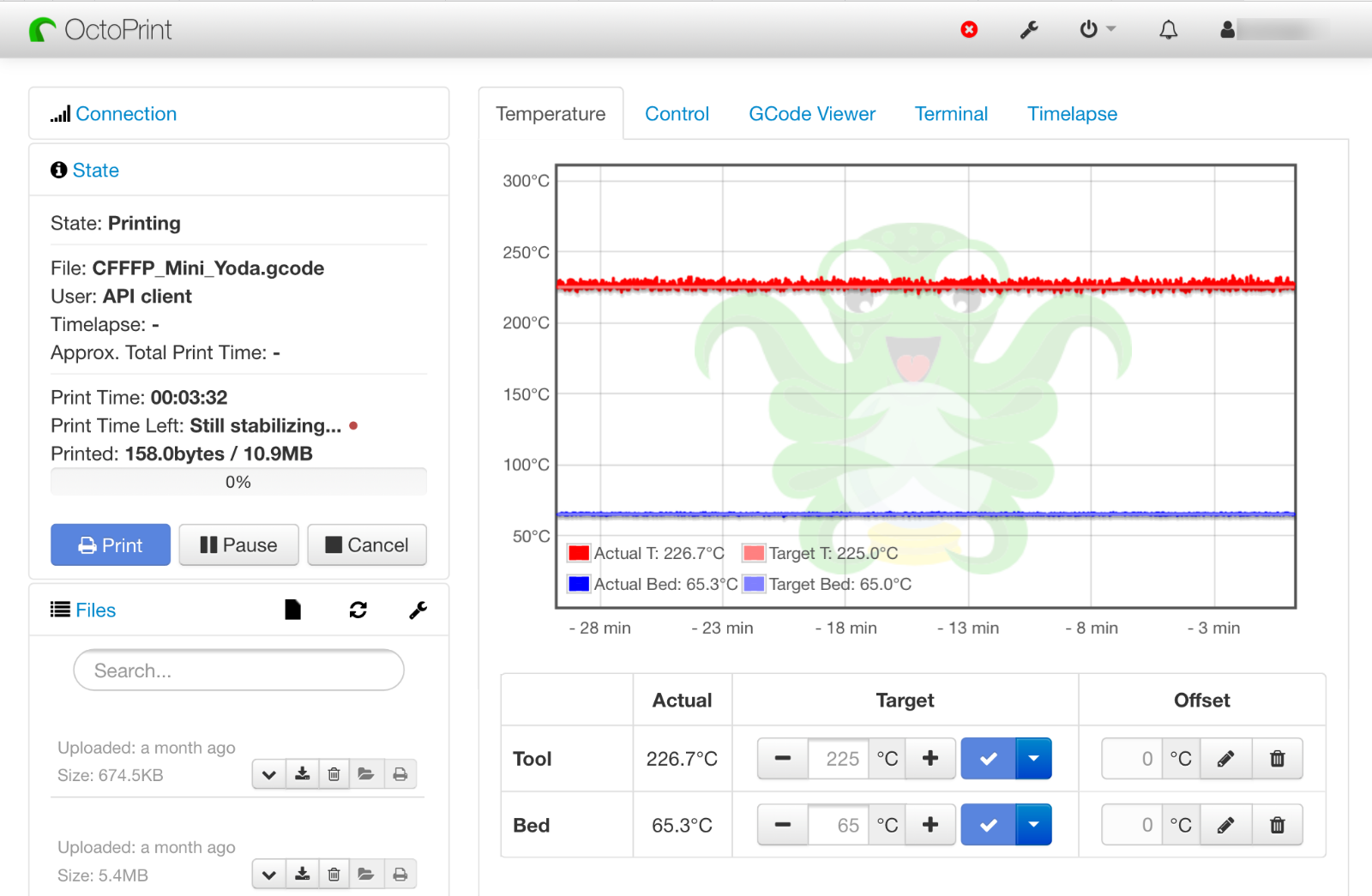

Hi, I wanted to get into PETG printing, so I wanted to print a temperature tower from 245 to 230.
The problem: After climbing up to the 245°C region, the temperature is jumping between 241°C and 249°C and the print actually never starts, not even after 15 minutes of waiting.

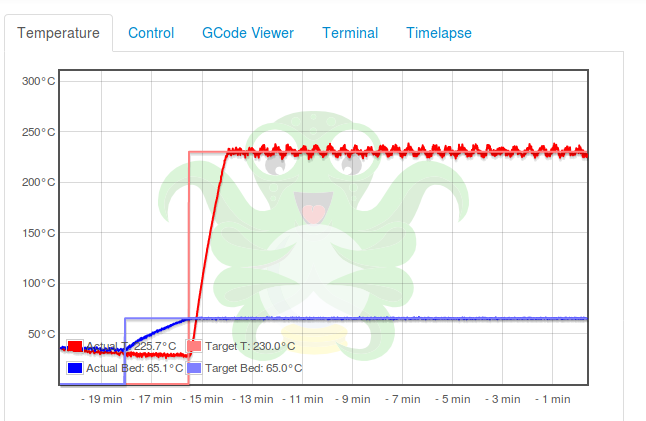

Edit: Here's an example for jumpy temperatures at 230°C
Bildschirmfoto von »2018-10-15 19-07-14«.png (61.03 KiB) Viewed 12914 times

I've found out that when I want to print at higher temperatures around 245 or so (for PETG), I can trick out the printer by starting at around 225 for the first layer and then change the temperature to the higher temperature, but that only worked for a few times, now it's not working anymore.
The printer now stays at the above picture (or see newer picture down below) and then at some point I interrupt the printing process after an hour or so, because there's no sign of life except for the heating.
What's wrong? Is the Thermistor broken? Is the heater broken? Does the stock firmware have a problem?

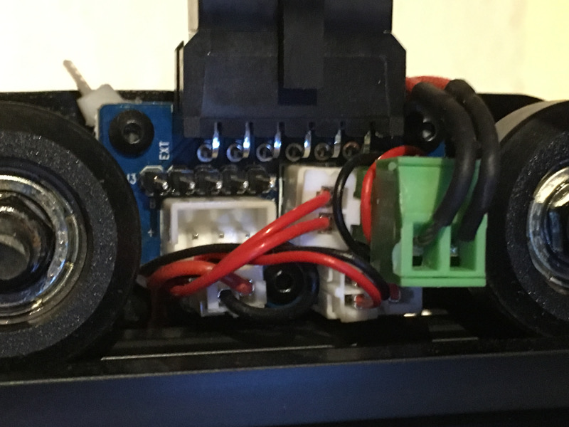

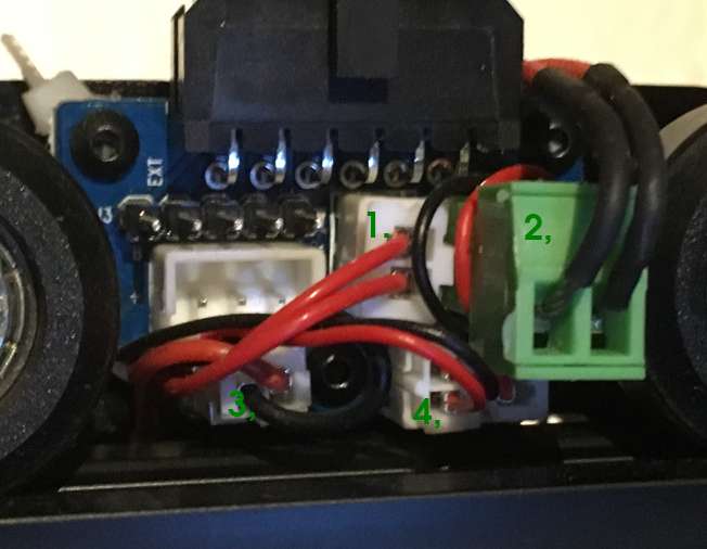

Question: Which connector is the Thermistor of the extruder?

Re: Jumpy extruder temperature
Post by _kaktus_ »
Hello.
:mrgreen:
In my opinion, connector no. 1. is: thermistor,
no. 2. is heater,
no. 3. & 4. fans.
If you have a multimeter, you can easily verify it.
Check the stability of connections.
When observing the temperature readings, touch the connectors, move the cables.
