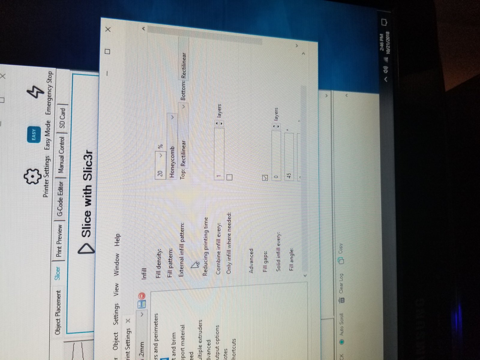

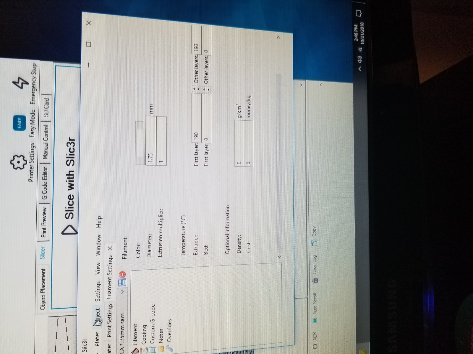

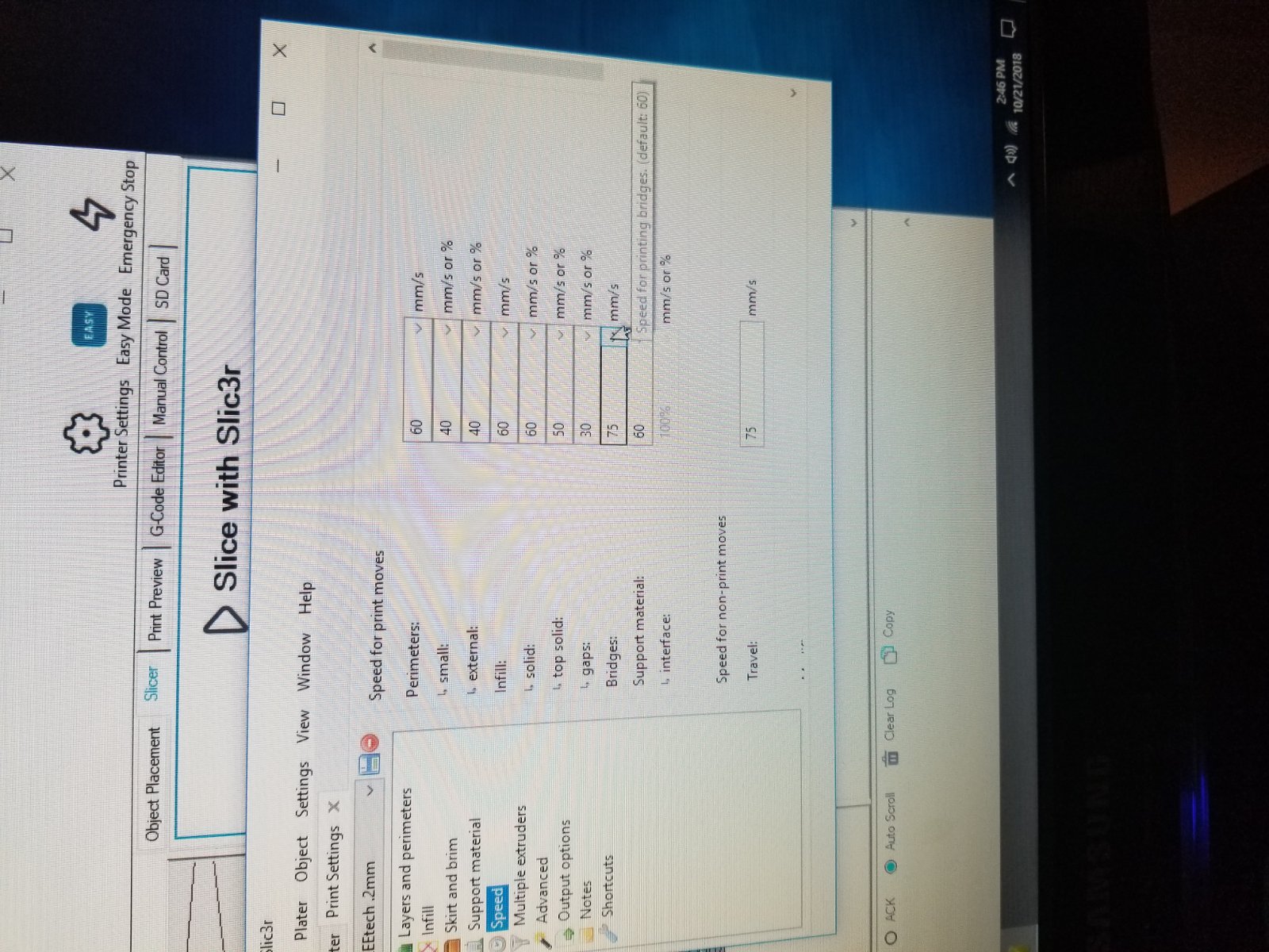

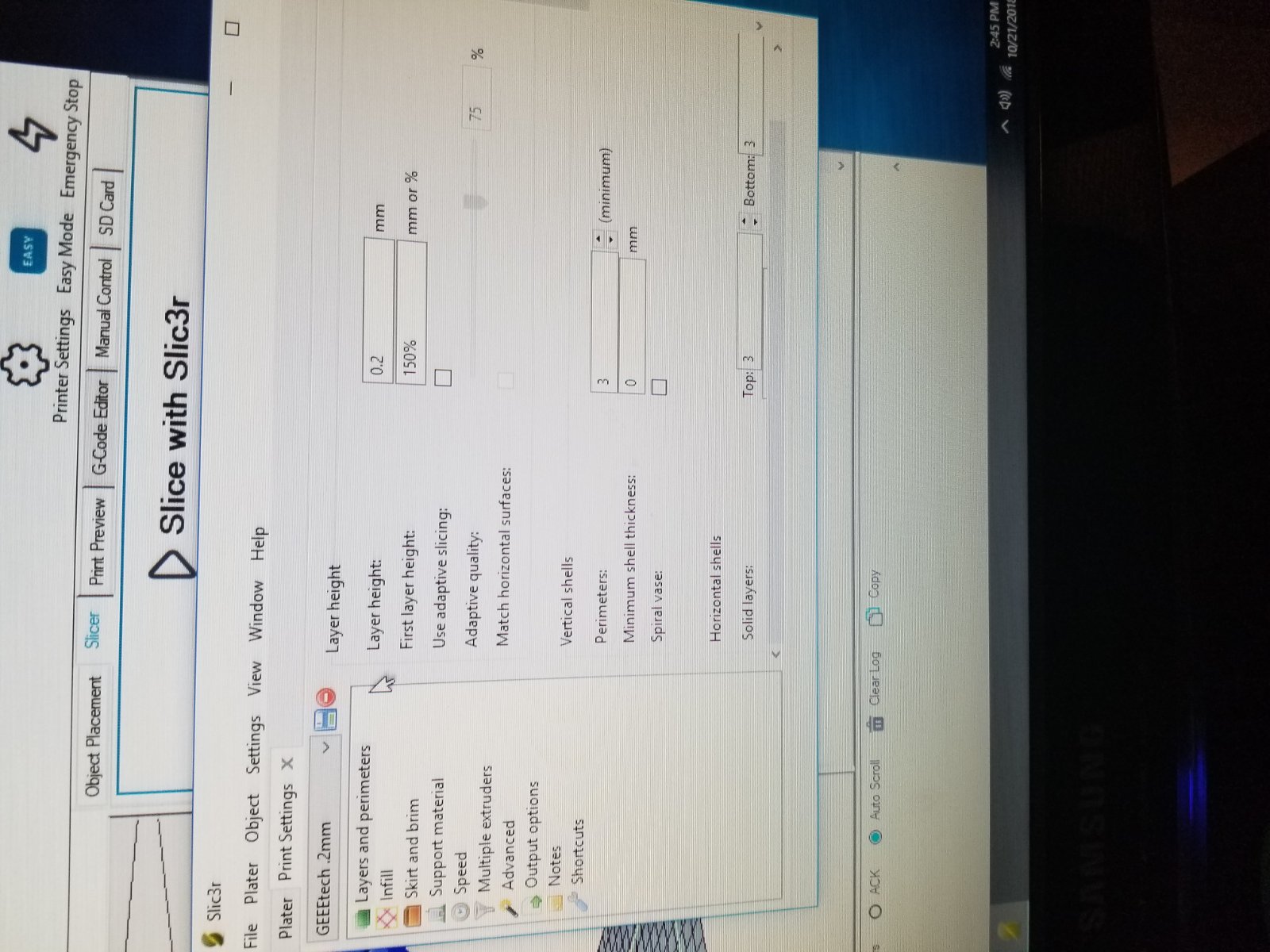

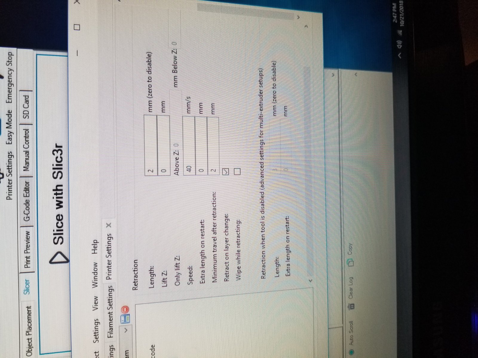

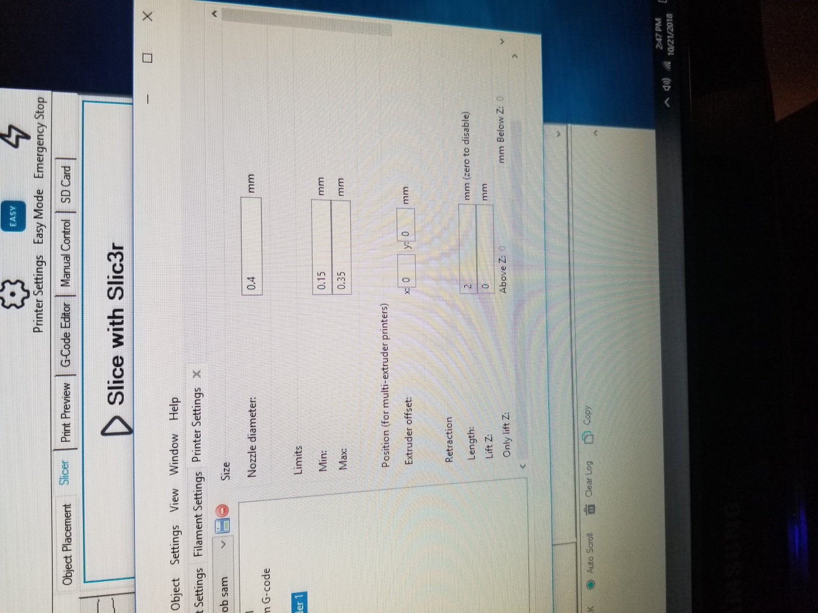

The pictures are the slicer settings and it's been showing 2h23min ete since this morning..
