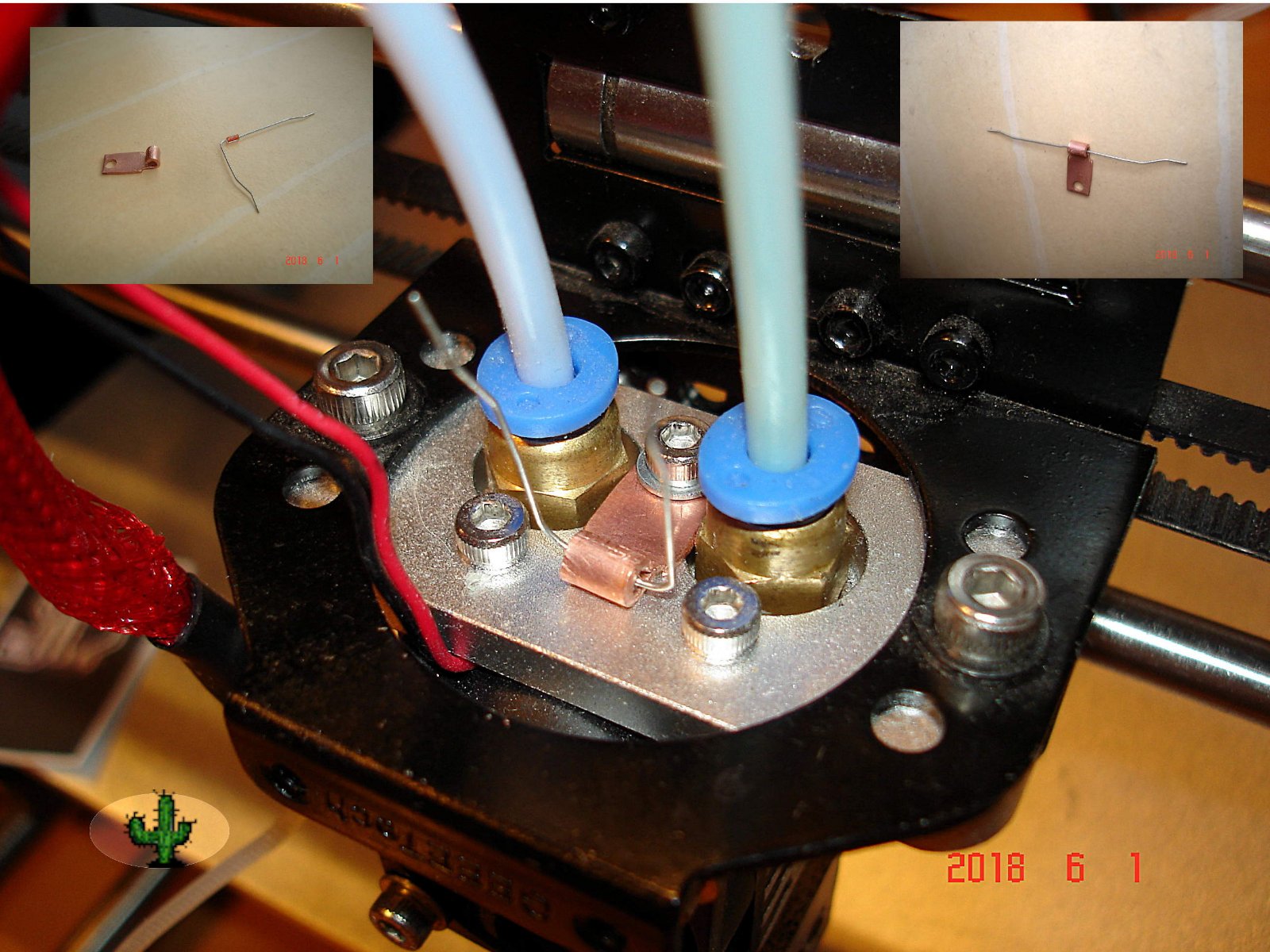

It was possible after some hardware modification. Thanks to my solution I have the possibility to measure the temperature in an additional place.
Of course, I owe it to the wide functionality of the controller board.
My modification was to add one more thermistor and connect it to an unused, third extruder connector. Luckily, the firmware provides its support.
For the new thermistor I have foreseen a special place. This is the highest point of the head block. After all, the heat always moves upwards.
I prepared a holder made of copper sheet and placed the whole under the existing screw between the handles of the bowden tube. Everything fits perfectly together.
Thanks to the new hardware functionality, in the slicer program that I use, I have an insight into the temperature readings at a new point.

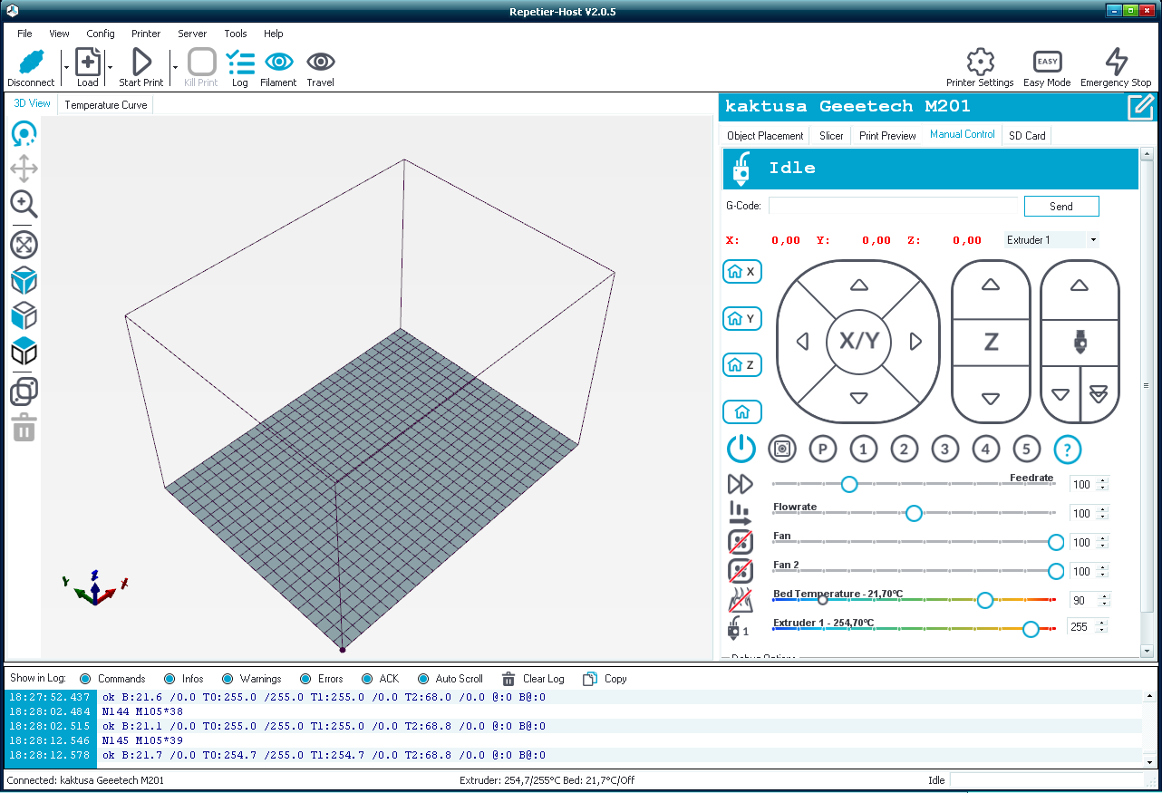

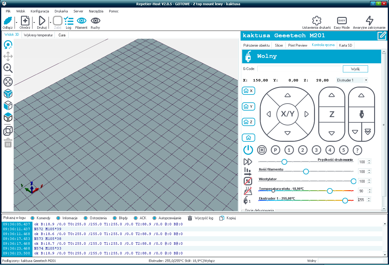

The experience consisted in switching on the heating of the printhead and observing the readings of the new thermistor.
I was very curious to what extent the head block would heat up when its small fan was switched off. 8-)
The temperature for the hot end element I set at 255°C. Only 5° higher than usual, during printing. For the results I did not have to wait long. The temperature rose quite quickly.
At selected intervals I was performing readings. You can see the results on the pictures.
temperature T2 when 11 minutes have elapsed
temperature T2 when 20 minutes have elapsed
temperature T2 when 25 minutes have elapsed
temperature T2 when 35 minutes have elapsed
The read temperature is presented in the log at the bottom. The values read from the new thermistor contain parameter T2. :D
In the final result you can see that the temperature has reached the value at which the filament starts to be plastic, :shock: which causes blockages and problems with dosing the material.
