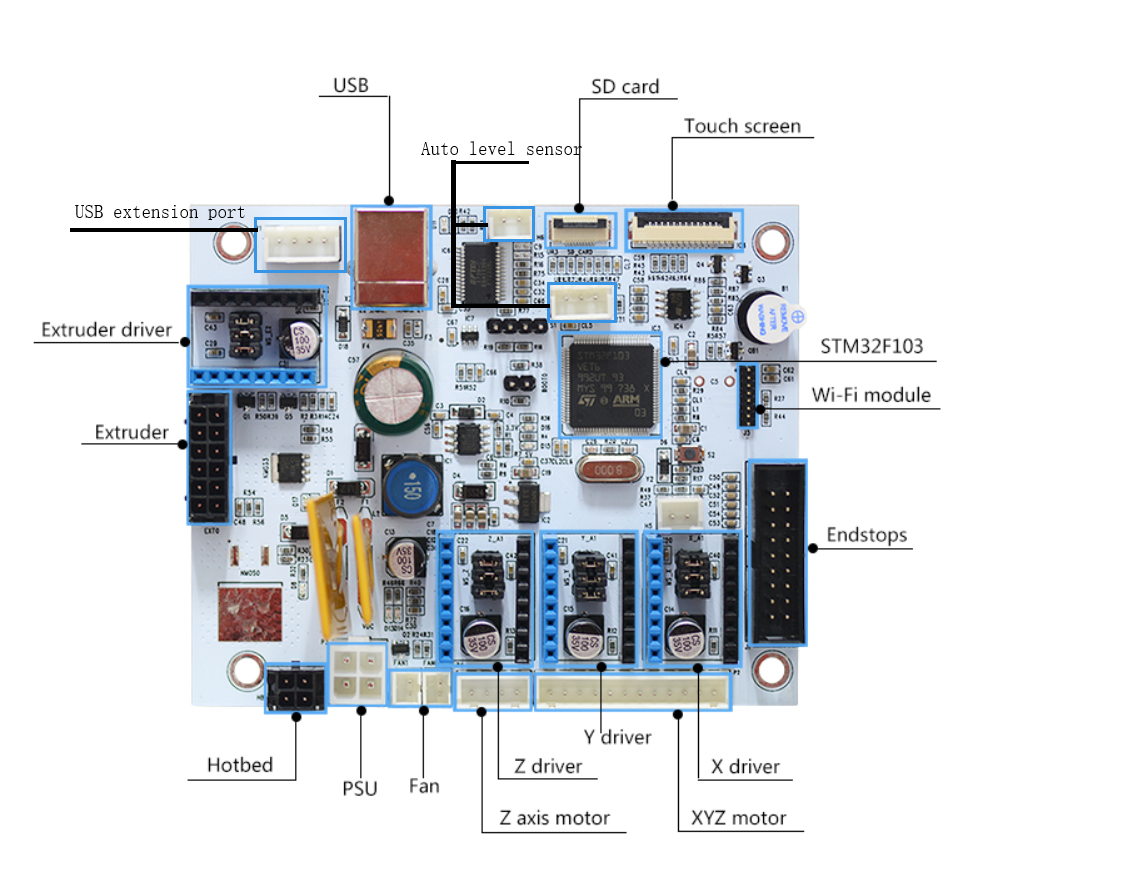

Source
1.Information for the Mainboard: GTM32 Mini S
http://www.geeetech.com/wiki/index.php/ ... TM32_Board
2.Schematic for GTM32 Mini S
https://github.com/Geeetech3D/Diagram/b ... MINI_S.pdf
3.Wires Update for GTM32 MINIS:
GTM32 MINI wires.png (671.42 KiB) Viewed 30798 times
(being updated)

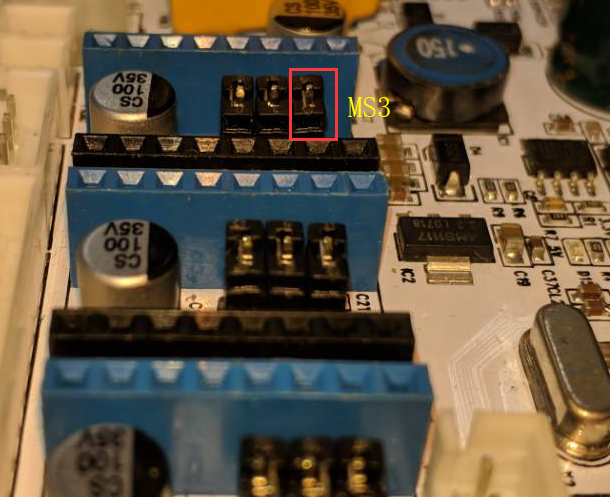

Upgrade
1.TMC2208
Compare the info of the TMC2208 and A4988
Tmc2208:
https://www.trinamic.com/support/eval-k ... stepstick/
A4988:
https://www.pololu.com/product/1182
The step of how to replace the A4988 to TMC2208
For the A30 with the 12V PSU and the HW is 2.0
1. Remove the MS3 of the jumpers off
2. Change the direction of the motor
http://www.geeetech.com/forum/viewtopic ... 054#p82054
For the A30 with the 24V PSU and the HW is 2.1/3.3
1.Upload the fw for A30 with tmc2208(Beta)
A30_TMC2208 test.zip
(78.21 KiB) Downloaded 1141 times
2. Remove the MS3 of the jumpers off
3. Change the direction of the motor
The jumpers MS3
jumpers ms3.png (381.03 KiB) Viewed 30793 times
