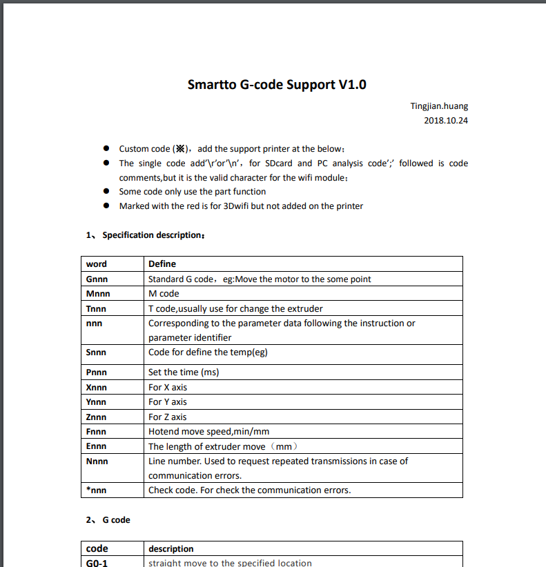

Hi,guys! :D
This file shows us about the smartto supported G/M code.
Refer it:
Attached:
Smartto code v1.0.zip
(577.25 KiB) Downloaded 2073 times
