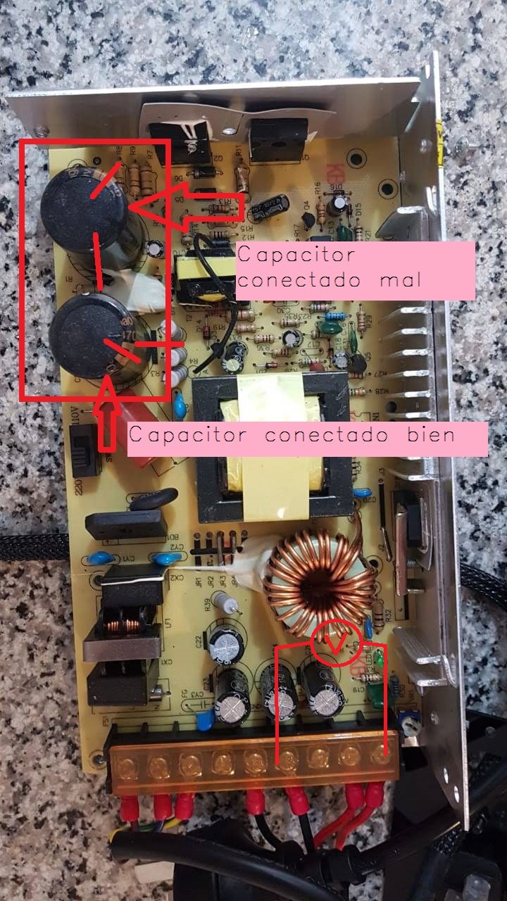

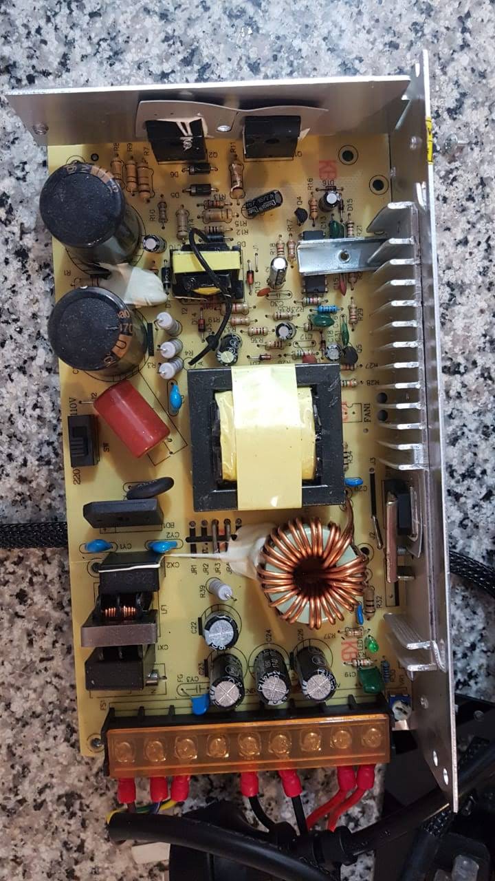

The same happened to me the first time, when i turned on the power supply, after at 2 minutes it burned off.
I disassembled it, and i saw that 1 capacitor has conected wrong. i changed the 2 capacitors because the capacitors were damaged.
for you know if you have the same problem, you should will check the voltage. if the voltage is 0 the prolem is in the power supply, if not the problem is in another side.

Thanks for sharing your experience!ldcomba@gmail.com wrote: Tue Dec 18, 2018 11:40 pm The same happened to me the first time, when i turned on the power supply, after at 2 minutes it burned off.
