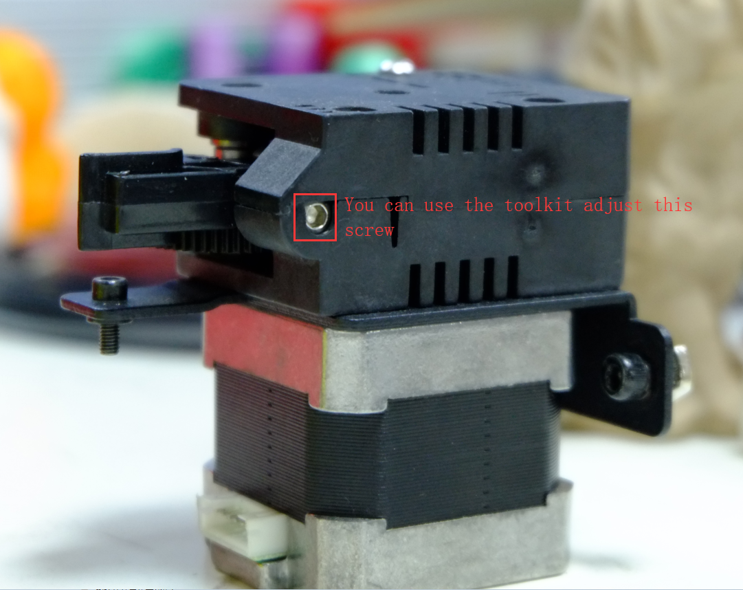

4)Check the spring of the feeder have enough strength/Too strength of the spring will make the filament broken
Feeder screw.png (1.07 MiB) Viewed 33049 times

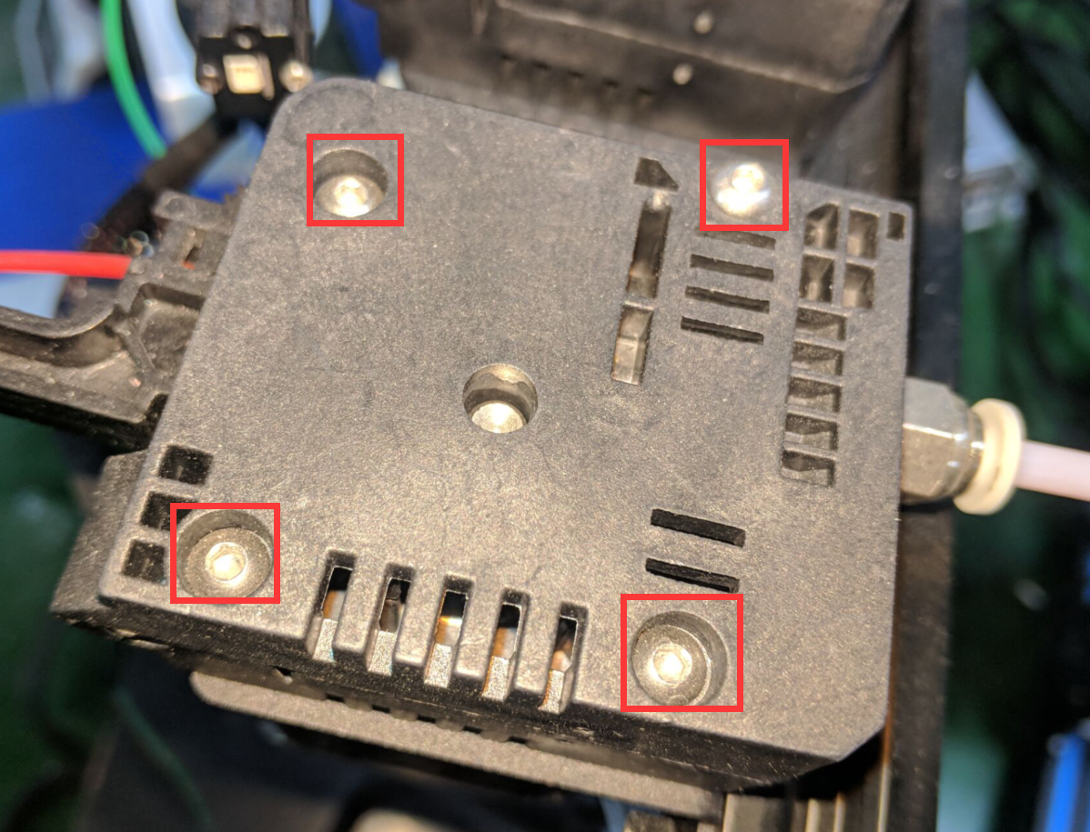

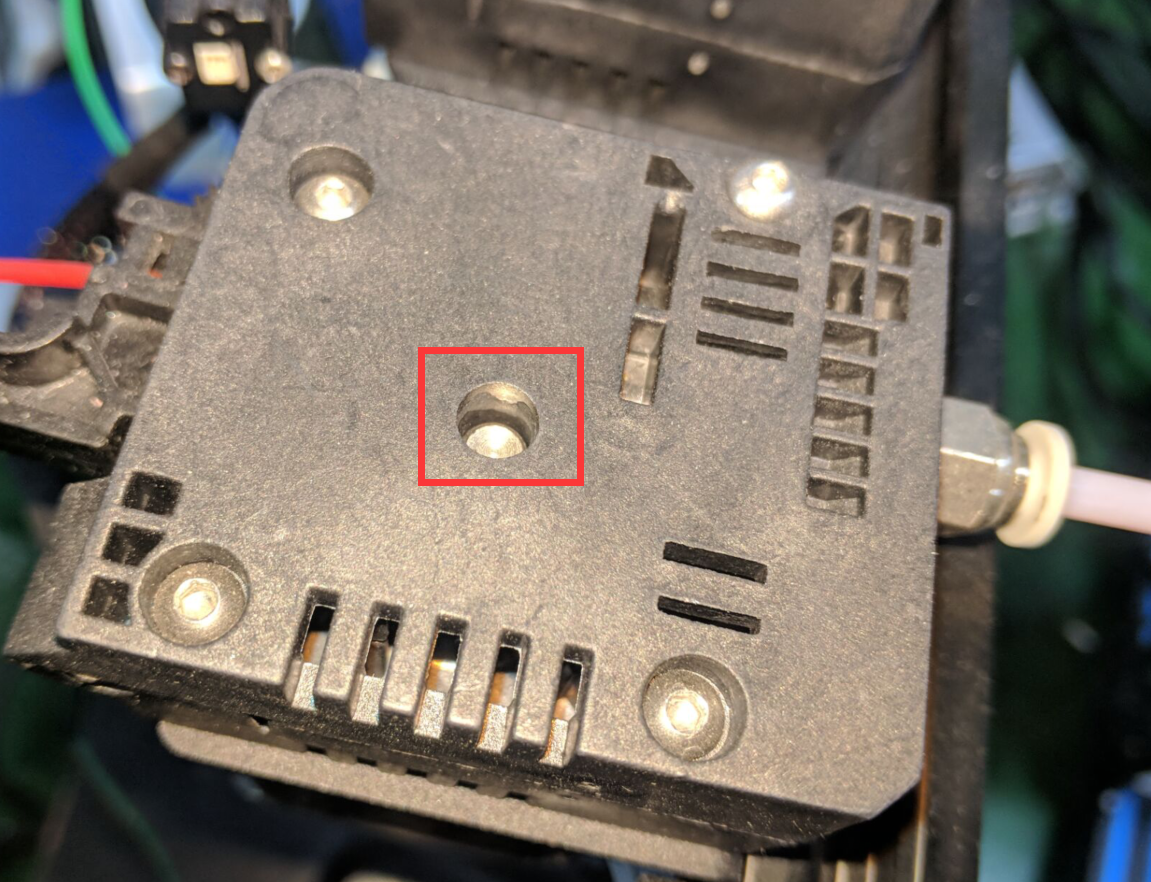

3.The extruder is very noisy A20M
1)You can add the oil to this area
Add Oil.png (1.41 MiB) Viewed 34922 times
2)You can loose a little for the screws

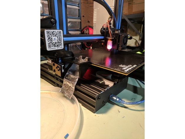

4.Add the purge bucket for your A10M/A20M
Refer to the link(By cmhnav Feb 2, 2019):
https://www.thingiverse.com/thing:3395883

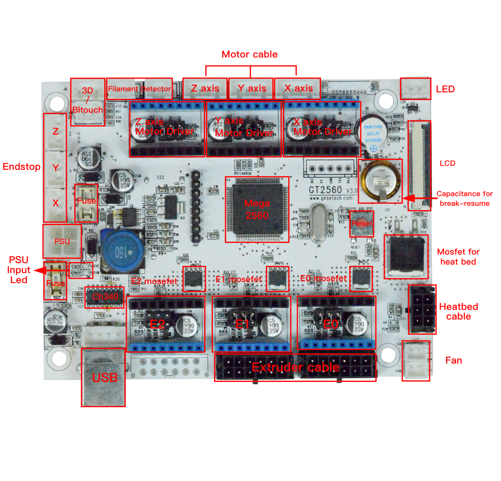

Schematics
Schematic for the new version Mainboard: GT2560 V3.0
The wires of GT2560 V3.0
GT2560V3 wires.png (2.69 MiB) Viewed 35562 times
