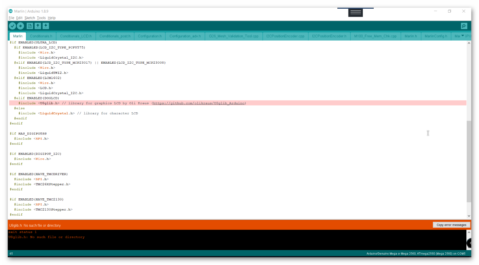

Hopefully someone can help. I am having issues in loading A20M 3d Touch software into Arduino. When I go to verify, I get an error stating "U8glib.h: No such file or directory". Before I got an error stating "exit status 1-Error compiling for board
Arduino/Genuino Mega or Mega 2560." I followed "blakilox" post and going to allow port pass through the firewall but now getting the above error U8glib.h: No such file or directory". Any help appreciated.

Re: A20M Essentials
You need to add it to Arduino IDE library.
Then the error will go.

christianbronton
Posts: 2
Joined: Mon Apr 15, 2019 9:30 pm
Re: A20M Essentials
Post by christianbronton »
Got it, Thank you
