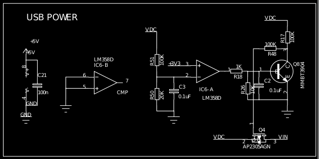

I looked at the motherboard. Q4 is burnt ... which is strange, it seems that Q4 is part of the USB POWER. it has nothing to do with the problem?

The solution you are talking about I found in the version of the GT2560 rev A+ controller board.
I would unsolder him even if he wasn't broken. ;)
Though broken, he is not sure either. We don't really know how he behaves.

_kaktus_ wrote: Sat Dec 15, 2018 11:39 pm I would unsolder him even if he wasn't broken. ;)
Why did you say that.
What's its use Q4? Really?

ok, I have to despair Q4 and .. it does not change absolutely anything ...
