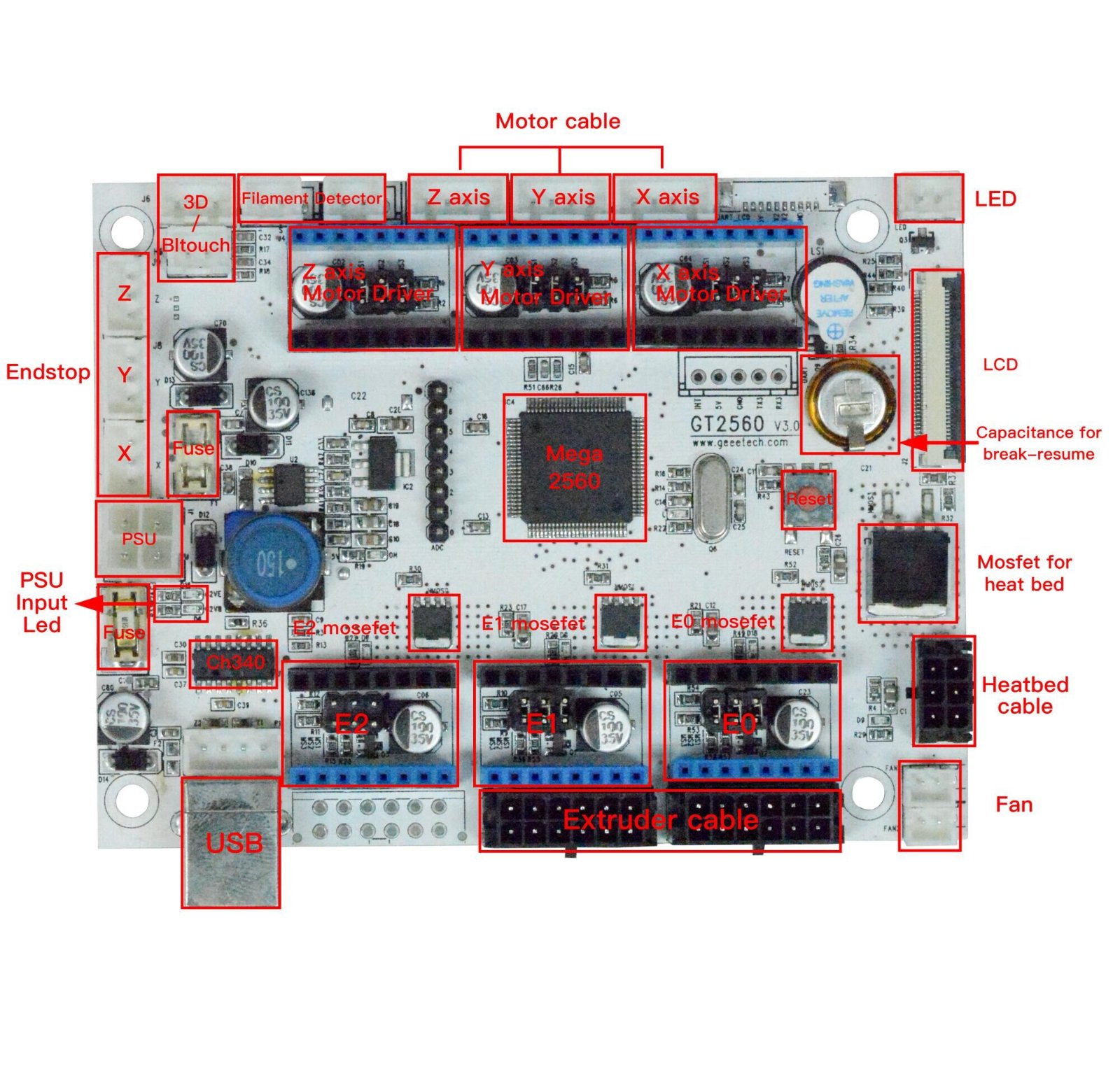

2.Check the vref of the Y axis motor driver board(Normal is 0.8~1.2V)
The travel speed no more than 150MM/S

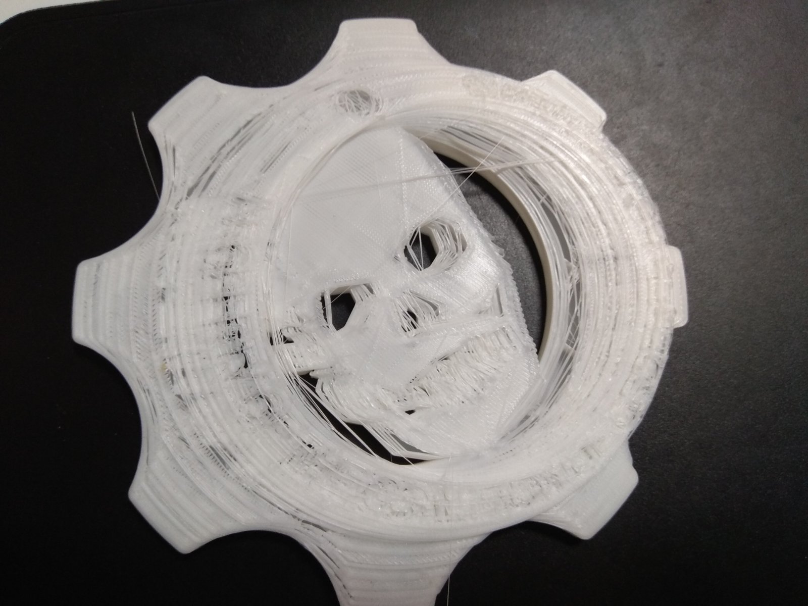

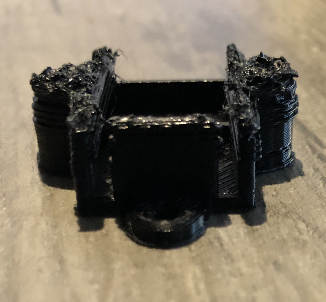

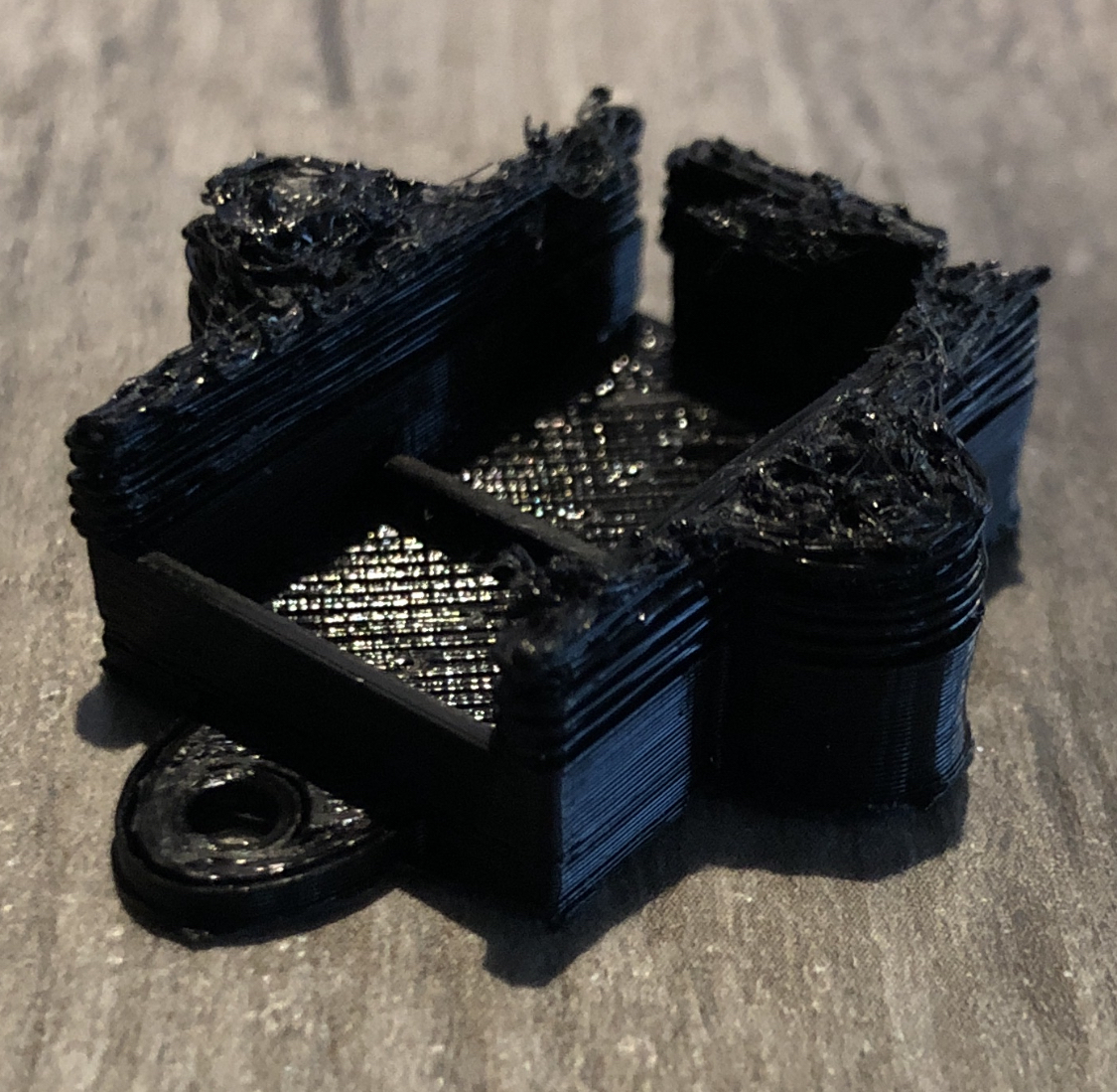

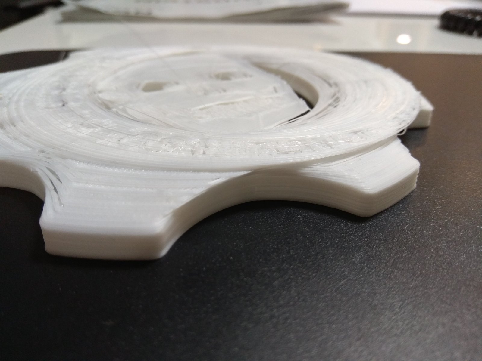

Thank you for your answer. I have tweaked the vref to 1.2v on all steppers but it didn't help much. The printing speed is 50 mm/s and the travel speed is 100 mm/s.
The layershifting is always in the same direction and it always begins when the printer have to fill very small gaps, mostly when printing the infill between tight walls.
Here some pics of the last fault print. The first layers printed perfectly, by start printing the top layers it come to the layer shifting.
Could it be, that the stepper motor is broken?
