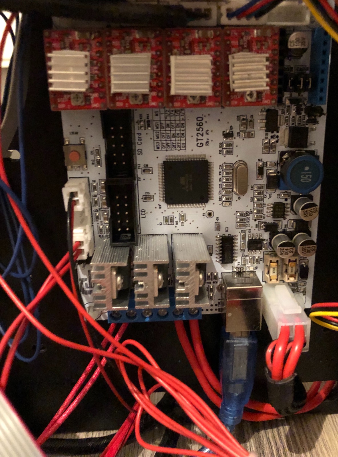

As for the Power Plates, I only know it‘s a GT2560..
I‘m leaving a picture as an attachment, maybe you‘ll know.(hopefully)

Your controller board is GT2560 rev A+.
You have presented the description in detail, it's good.
Unfortunately, the fault does not seem to be light. :roll:
No communication via USB, and no control for the stepstick modules can be a sign that the main µC is dead. :(
It's a very nasty fault.
At the moment you can try to connect the printer to the computer, run the terminal program, configure and establish a connection.
After resetting the printer, messages should appear in the terminal.
I suspect that nothing like that will happen. :cry:
Suggests that you contact your salesman and tell him about the issue.
The printer is under warranty so I expect the controller board to be replaced with a new one.
Here
you will find a schematic diagram for your controller board.
