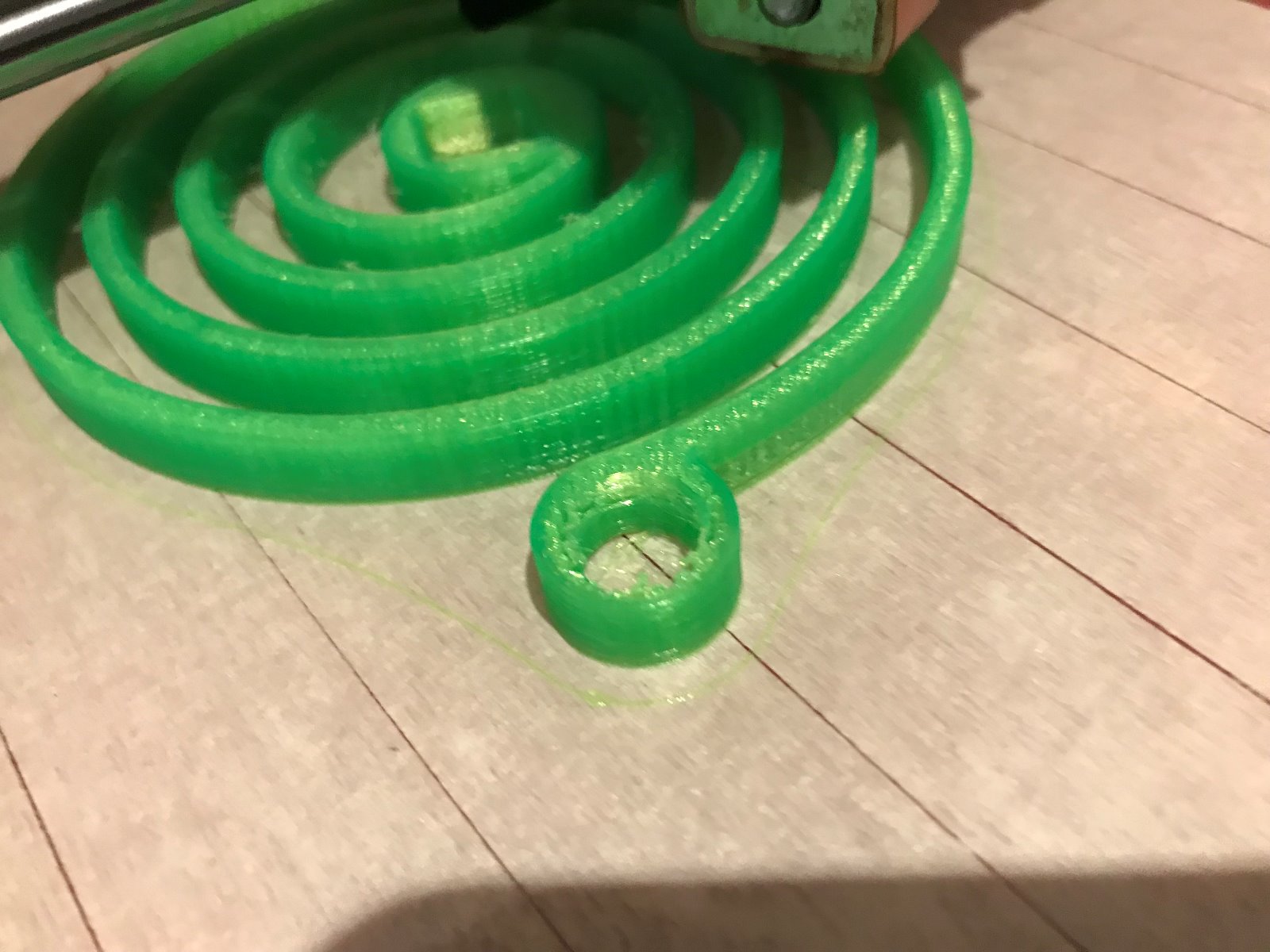

However, started a new print and it seems as if some code goes missing? by this I mean that on the present model there is a bore at the end of a torsion spring that has the internal walls for about 4mm of height then they stop. So the infill carries on as do the outer walls. As this boss is approx. 8mm in height its a real pain.
When I check with the slicer all the walls are present and correct, it's just that the extruder doesn't output filament
I was going to upload an image but can't work out how to.

Oooh! I did manga to!
The image also shows that to the right of the boss it's missed layers on the outer wall of the spring.
And a previous attempt at this print I had problems with the internal walls of the middle square hole, the walls were just as if it was printing an in fill wall.
