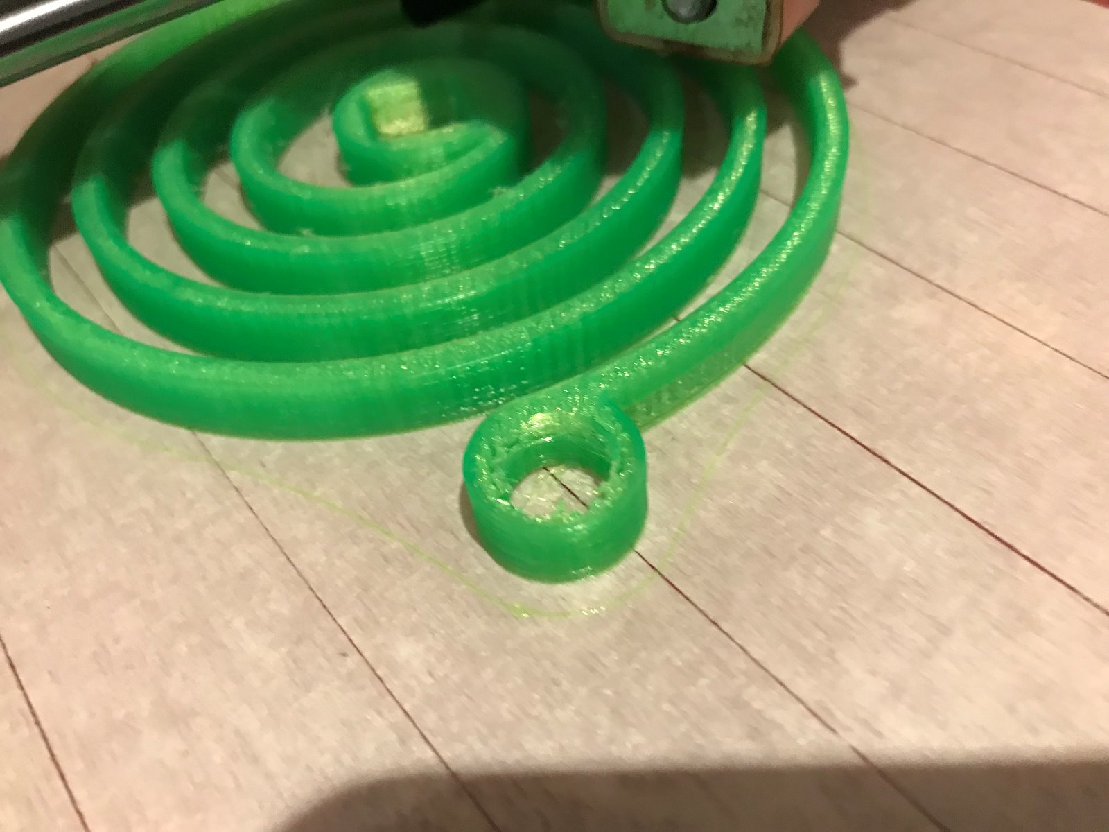

Hi all,
Well, thought I'd update on different issues I've experienced!
Things I have tried :-
0.4 Nozzle
different filaments
extruder motor steps, (calibrated to fairly precise, 100mm of movement for 100mm expected, wound down to 80% to stop over extruding when printing a benchy) back to correctly calibrated
different slicer
reloaded the firmware
Problems encountered are :-
missing/interrupted layers
infill walls totally missing, (yet shown in slicer model)
infill showing spotted extrusion all through the layers
printing a curve on the bottom of a gear tooth when all the others are flat
I have changed the extruder motor now but need to test thoroughly.
I'm thankful for your contributions but it seems that I am chasing ghosts here.
With the new motor all seemed good, (not unusual for me it seems as each change seemed to resolve the situation until a couple more prints are done)
However, started a new print and it seems as if some code goes missing? by this I mean that on the present model there is a bore at the end of a torsion spring that has the internal walls for about 4mm of height then they stop. So the infill carries on as do the outer walls. As this boss is approx. 8mm in height its a real pain.
When I check with the slicer all the walls are present and correct, it's just that the extruder doesn't output filament
I was going to upload an image but can't work out how to.
Put it on Flickr so my wife has a picture of it for which she is truly grateful! Not!
ve even tried the "Recommended" setup in Cura.
Still battling
Thanks again for your assistance, please keep trying
Rick
Re: Extruder feed wheel jumping backward
Posted: Sun Feb 03, 2019 4:00 am
by ricky007
Oooh! I did manga to!
The image also shows that to the right of the boss it's missed layers on the outer wall of the spring.
And a previous attempt at this print I had problems with the internal walls of the middle square hole, the walls were just as if it was printing an in fill wall.
