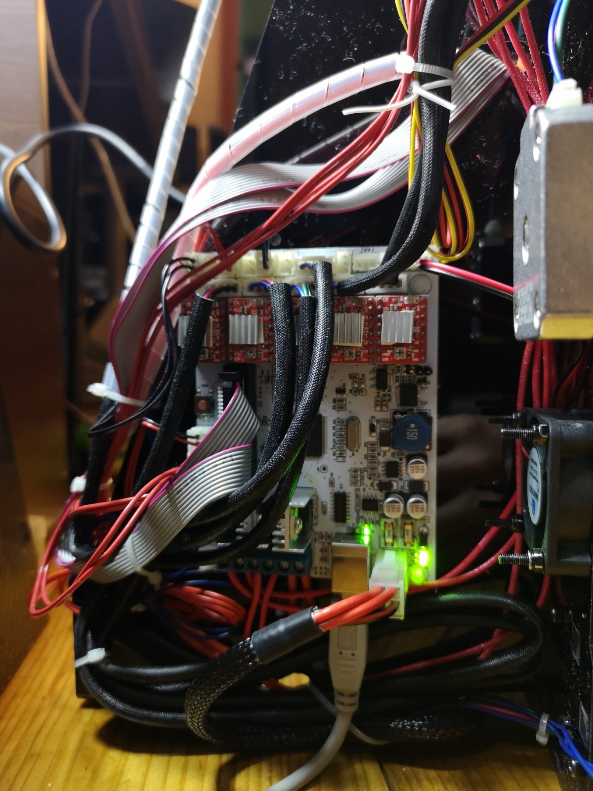

Currently the printer still exhibits the following abnormal behaviour:
1. X axis will only travel to the left (-). When I send a command to move right (+) from Repetier the motor seems to try to move but it is unsuccessful.
2. Z axis will not travel in either direction. The same thing, the motors vibrate, they try to move but it does not work.
I have attached a photo of my wiring.
Since my Y axis works normally, I have plugged each motor into the Y axis connector to make sure they work. They all do!
So, what could it be?
Maybe the drivers?
The firmware?
Maybe the drivers?
The firmware?
- IMG_20190116_223521.jpg (339.41 KiB) Viewed 10821 times

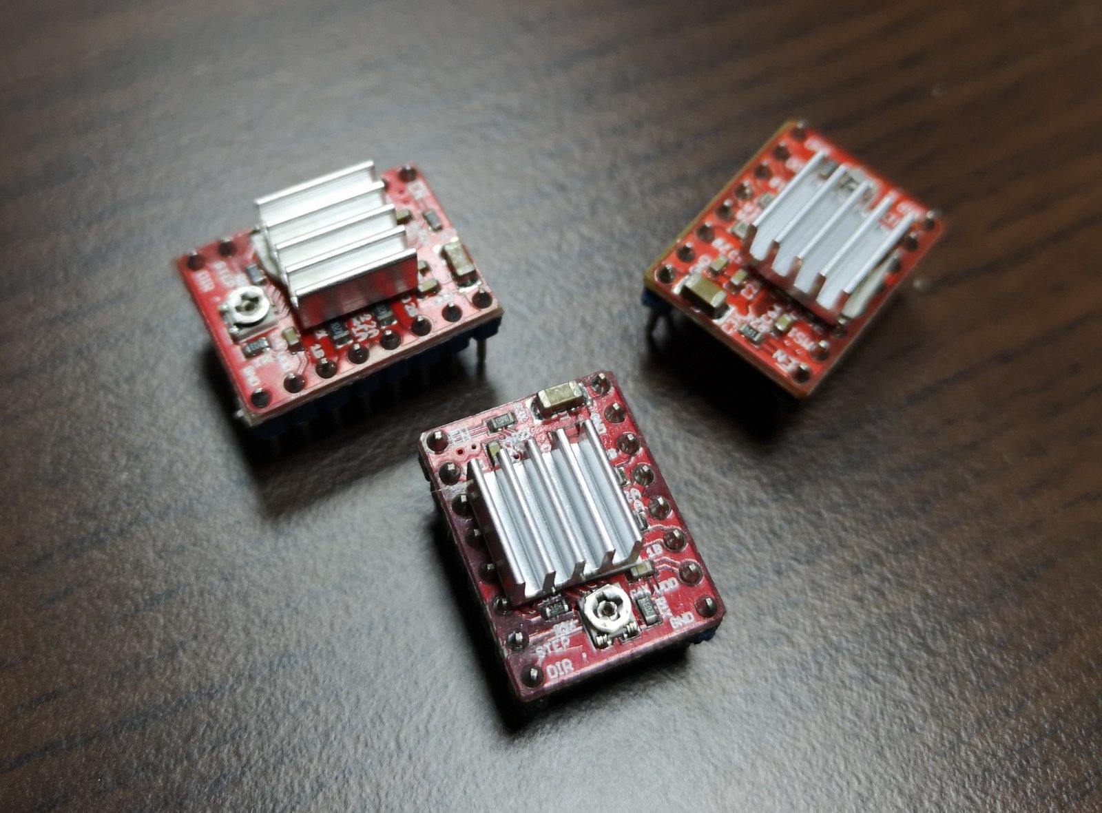

So, I ran more tests. I moved the drivers around. It seems only the Y axis driver works properly.
The other 4 drivers (X,Z, Extruder 1, Extruder 2) have issues. 3 don't work at all. The 4th one sometimes works and sometimes only turns the motor in one direction.
What can I do to get my long-awaited Geeetech printer up and running?

Re: Board connections mixed up
Hello.
In this case you need new stepstick modules.
Try to analyze what could have caused this state of affairs.
Hi.
After the appearance of the modules from the photo I guess that they are A4988.
If you want to be 100% sure, peel off the heat sink, then you will be able to read the marking from the chip.
One fact drew my attention.
On the photo you can see that the heat sinks are very nearby the module leads.
It is worth checking if there is a short circuit in this place.
In my opinion, it is very unlikely that the stepstick modules were factory damaged.
I have one more proposal.
It is worth checking if the order of wires is identical in each of the cables connecting the stepper motor.
Your solution gave me hope! I really thought "maybe I made a mistake! maybe I shorted the stepsticks and that's why it doesn't work!".
Nope!
I just spent two more hours checking things. The stepsticks all had some of that adhesive paper in between the heatsink and the leads. I moved them further away from the leads and the printer still doesn't work properly.
I also checked the colour sequence on the cables connecting the motors to the board and it is the same for every cable. They are also connected the right way to both motor and board. Unless there's some internal damage under the mesh of those cables, where I can't see, they are not the ones to blame. Also, if I move my one functional stepstick to a new position, that motor starts to function normally.
On Tuesday at noon I get 5 brand new stepsticks in the mail. I guess we'll see what happens then!
Nope!
