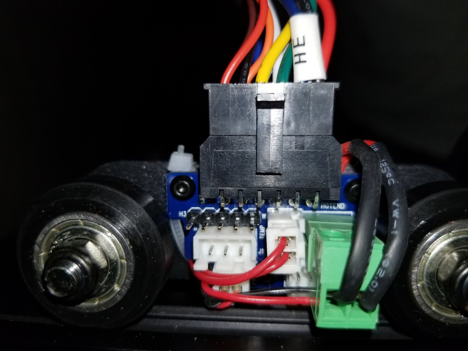

Just got my first Geetech A30 Newest version. I can't figure out how to wire the BL Touch. I got the captive to work just to make sure it does. I know the 3 pin goes in the 3 pin. It's the 2 pin i can't figure out. Thanks in advance.

Actually everything goes in the 5 pin connector above the 3 pin. From left to right it's brown orange yellow black white
