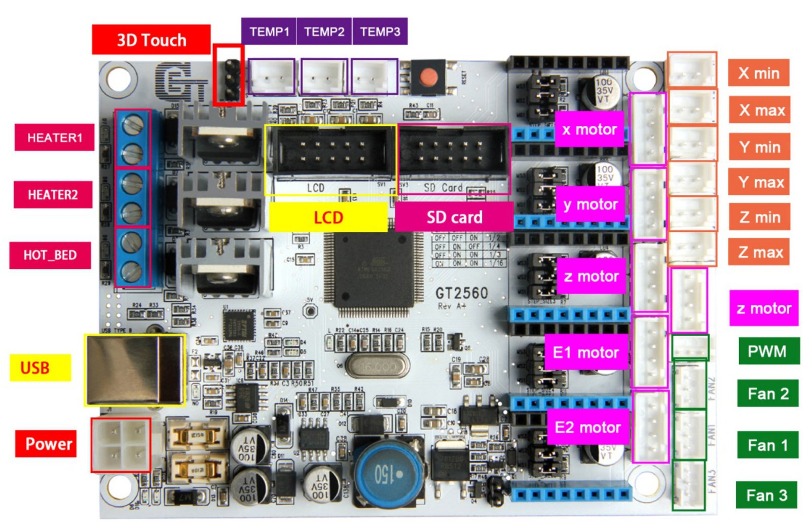

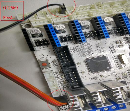

Hi SakisMicha,
You don't say what board you're attempting to wire to...
But let's assume it's the GT 2560 A+ , the board where you don't need to solder anything...
I've attached a picture of this board, and then a picture of the wiring I used to connect my 3d touch (Same for the BL Touch).
That's 2 wires to the 'Z Min' plug, three wires to the three pins marked '3D Touch' on the first picture.
There is also another post you could look at to help with your set up.
https://www.geeetech.com/forum/viewtopi ... 66&t=68258
Hope this helps,
Gerry
