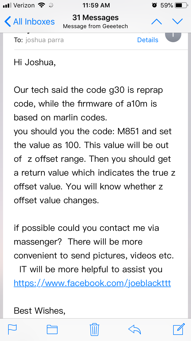

I received this from geeetech.... just sharing. As u can see in the picture tech support has been helping me out very responsively and positively. Tony at geeetech has been great
Since then I use G29 as was told in response before me as well
Hi Joshua,
Our tech said the code g30 is reprap code, while the firmware of a10m is based on marlin codes.
you should you the code: M851 and set the value as 100. This value will be out of z offset range. Then you should get a return value which indicates the true z offset value. You will know whether z offset value changes.
if possible could you contact me via massenger? There will be more convenient to send pictures, videos etc.
Hi Joshua,
