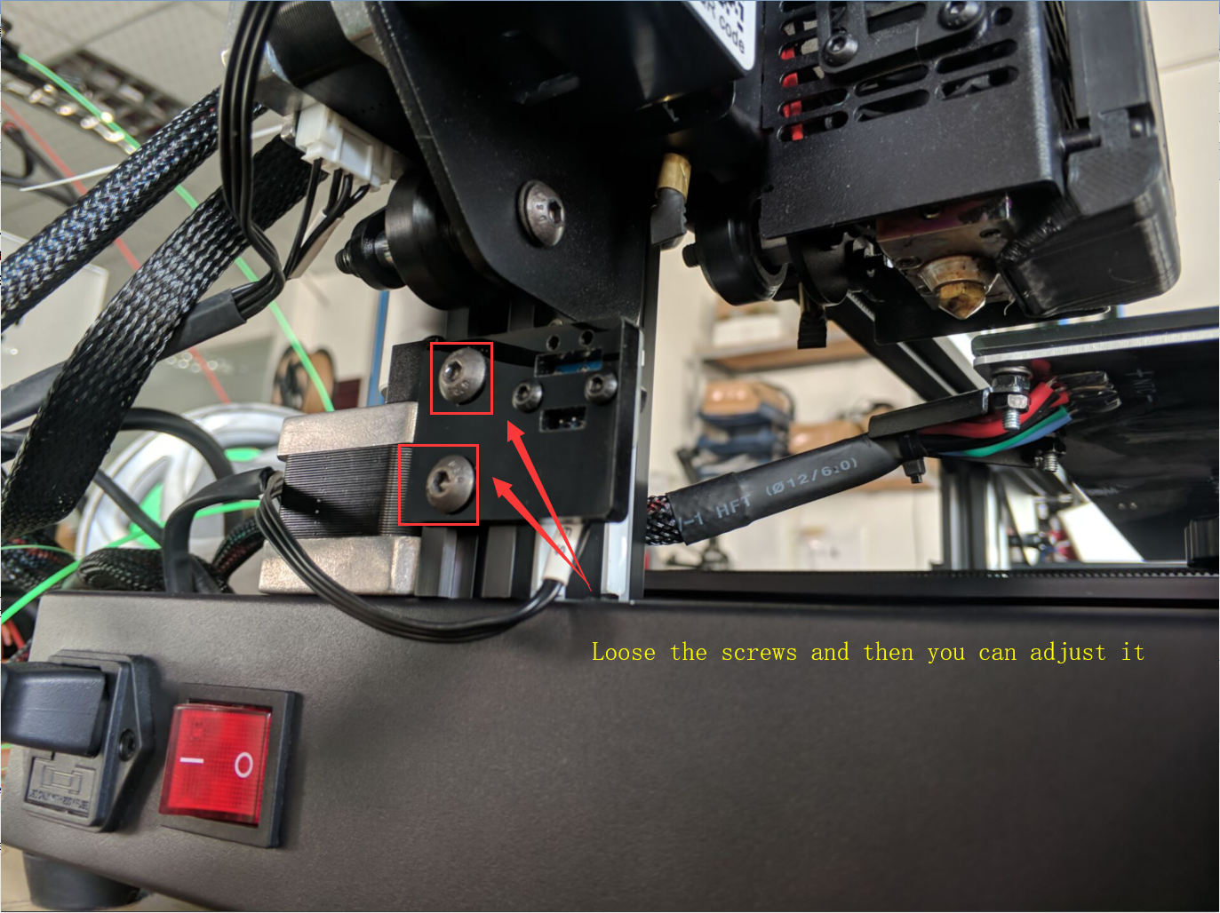

Measured from right to left, my x axis is approx. .5 -to 1mm higher on the right side. How much deviation from horizontal is acceptable? The next question is how do I adjust the tilt? I do not see any way to adjust the 2020 extrusion. None of the screws appear to be adjustable.
My bed is also tilted down 1mm on the right side when all the springs are compressed so the combined difference between the gantry and the bed makes bed leveling difficult.
Re: Leveling gantry
I think you should check the lowest point at first.
Then try to adjust the endstop part and leveling your hot bed again
A20M-endstop kit.png (1.61 MiB) Viewed 3713 times
