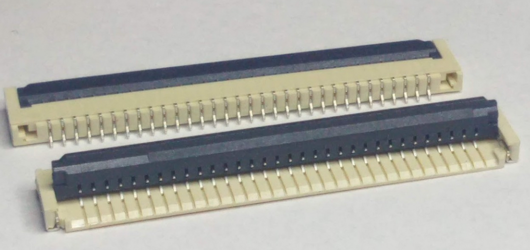

The FFC connector has a snap-flap flap on the hinge.
This is the black element.
Pick it up slightly to jump up.
Slide the flat FFC cable evenly into place. Close the flap.
If you fail to insert the cable correctly into the display socket, the display will not function properly.
Example picture.

This picture does not look like the one on the new model A10M. The connector is really small. No flap.
