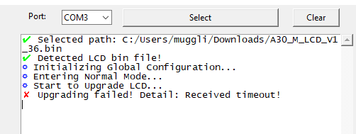

I made the Firmware update on my 3D-Printer and now i can not conect the printer with my Computer.
The error message is " no COM selected". I don't disconet the USB-cabel.
And the touchscree of the 3D-Printer is black.
Please help me.
Re: Geeetech A30 no COM selected
You need to check the USB drivers install correct or not(CH340C)
Then you need to insert the sd card to A30 printer.
Restart it and upload the firmware for LCD.
