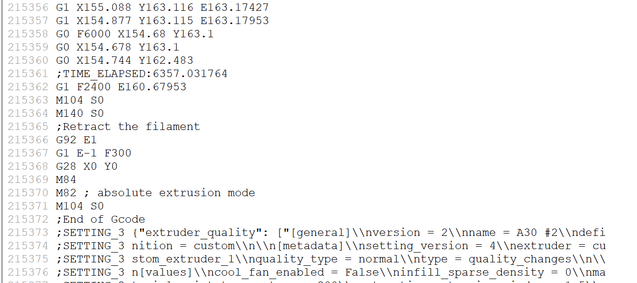

I've checked it.It seems normal.
I have a question.I can't find the "end gcode" in your gocde.
Maybe you've deleted it.
End gcode.png (75.01 KiB) Viewed 11613 times
