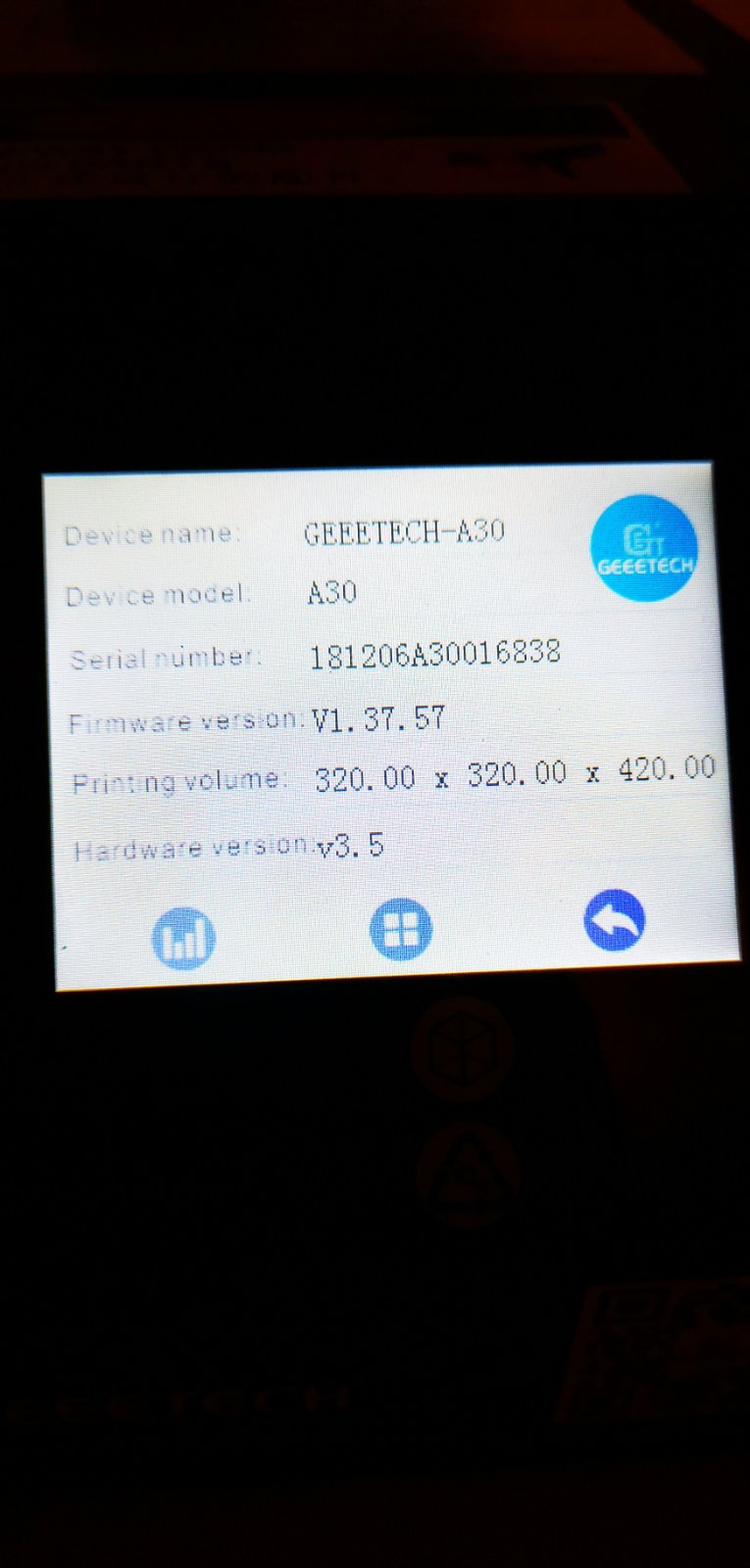

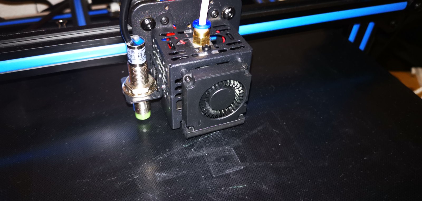

I try to ad 2 Pictures to show you my problem. the printer thinks the position of the NPN senosr is in the Front of the Printhead. But in my version the Sensor is locatet on the left site of the Printhead (see Picture).
Firmware version is V1.37.57
Hardware version v3.5
Sensor Location is on the left of the printhead not in the Front

This is my problem,
I have the hardware version 3.5 in your version is the NPN sensor in the front of the print head. In the version 3.5 is the sensor located on the left side of the print head.
How can I change the coordination of the proximity sensor sensor?
