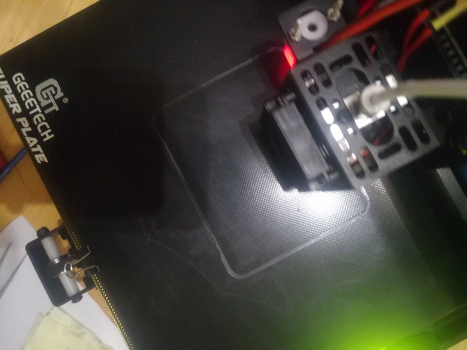

I have recently bought a 3d touch sensor for my A10. I have installed the sensor successfully, but the auto bed levelling doesn´t work as expected. The 3d touch measures all points on the plate, but when I print on one side the nozzle seems too high and on the other side it is definitely too low (see attached picture). Has anyone a solution for this problem? Could it be that the firmware has the wrong axis orientation that the leveling grid is 180 degree wrong?

You can refer to these:
1.Check your z offset is correct or not
2.Check the 3dtouch deviation with the gcode(You can test it 3 times then you can get the result)
The deviation should <0.1mm
Re: Problem with 3d touch and bed leveling
thank you for your answer, but how do I check the deviation and which gcode do I have to use?
You can try to use the G28 Z0 and G28 Z15
Then test them several times.
Thank you i will try it.
