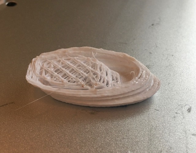

VikingHighlander
Posts: 8
Joined: Thu Nov 14, 2019 4:05 am
Re: g2s pro belt slipping
Post by VikingHighlander »
Picture is take from the front (over the LCD screen). So you see the movement away from the Y-axis. This is a mechanical fault of some kind, not the slicing or drawing.
If I print a small dice, aprox. 2x2x2 cm in center it is ok. but when I print any other figure that has a larger print surfice, this happens.
