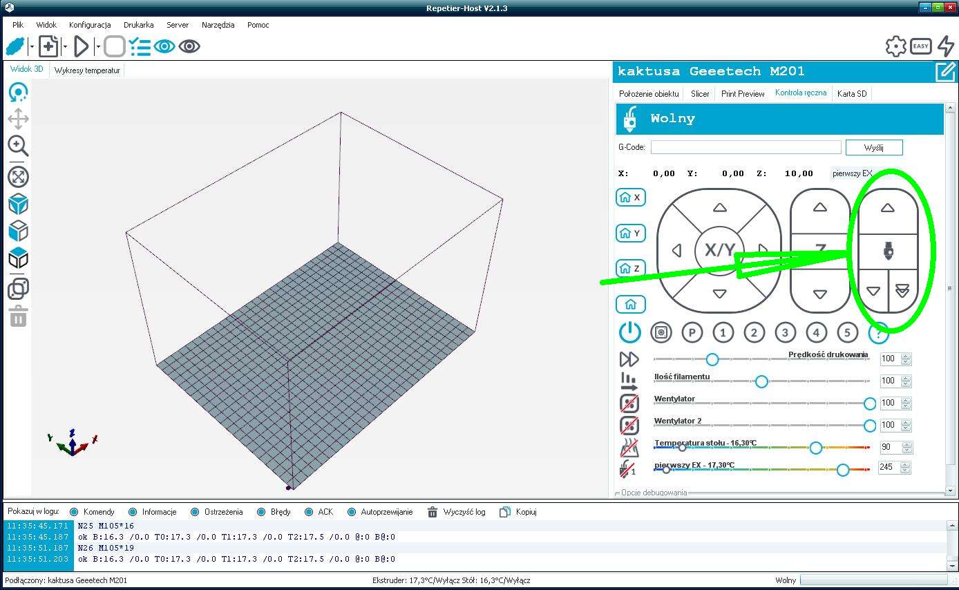

I was referring to whether you tried to start the extruder manually via the control panel.
See image:
I also asked if the filament parameters (diameter) set in Slicer are correct.
Calibration of the extruder can be carried out easily.
For example:
  • from the entrance of the foundation to the extruder you measure a distance of 10cm.
  • warm up the head and use the control panel to feed a section of 10 cm.
  • check on the filament whether the marked section has been correctly taken to the extruder.
