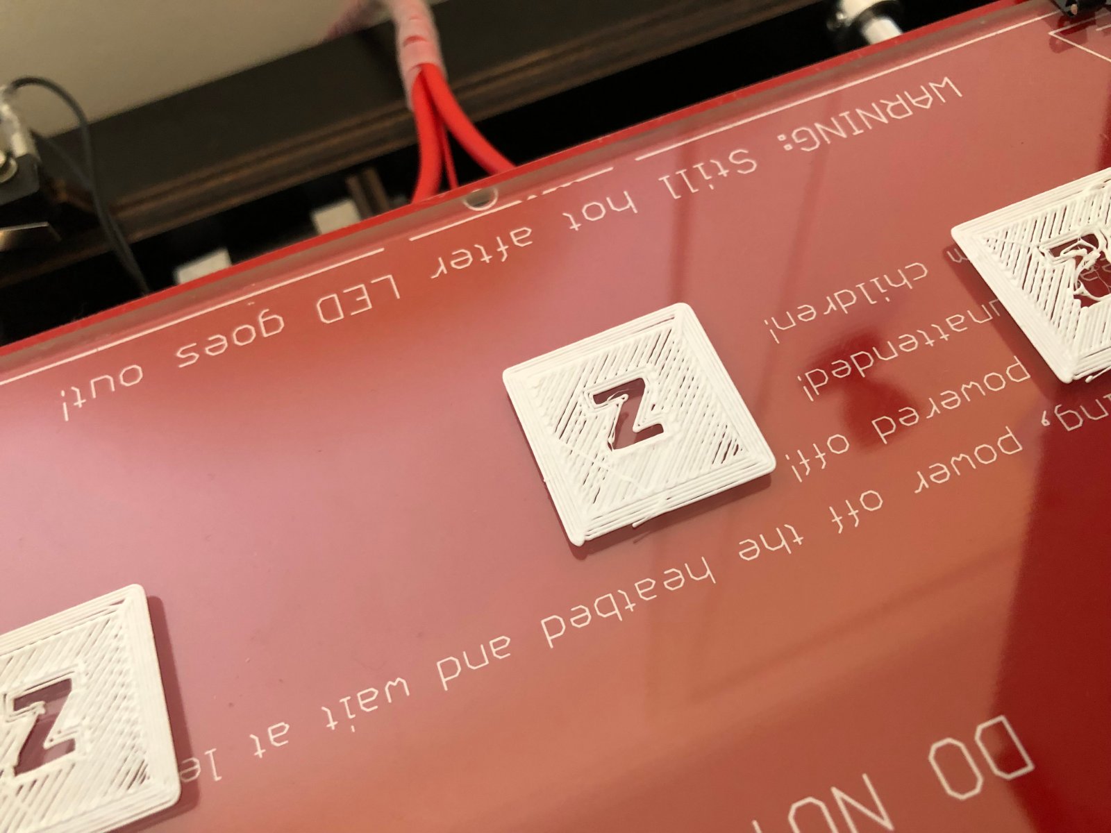

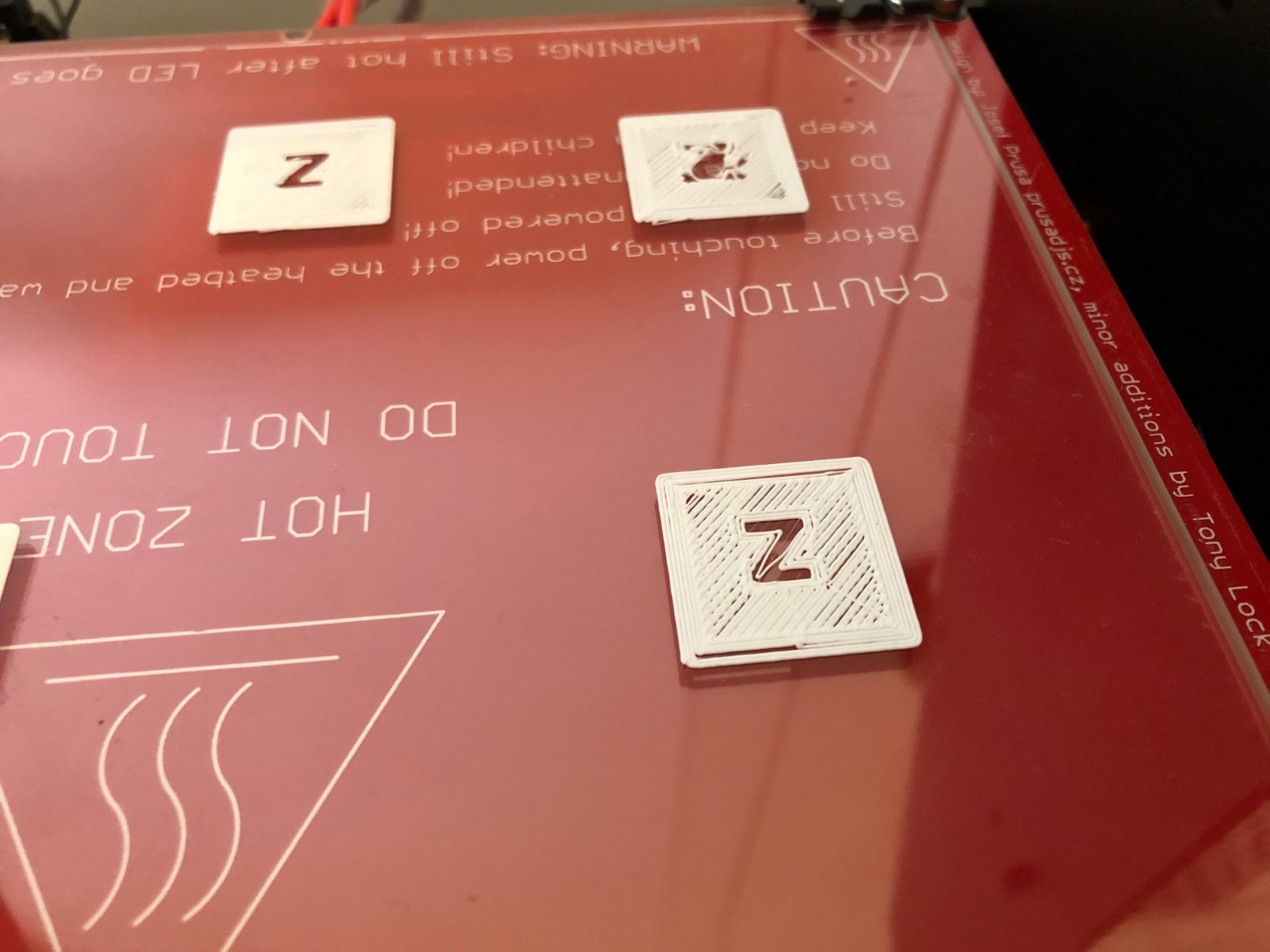

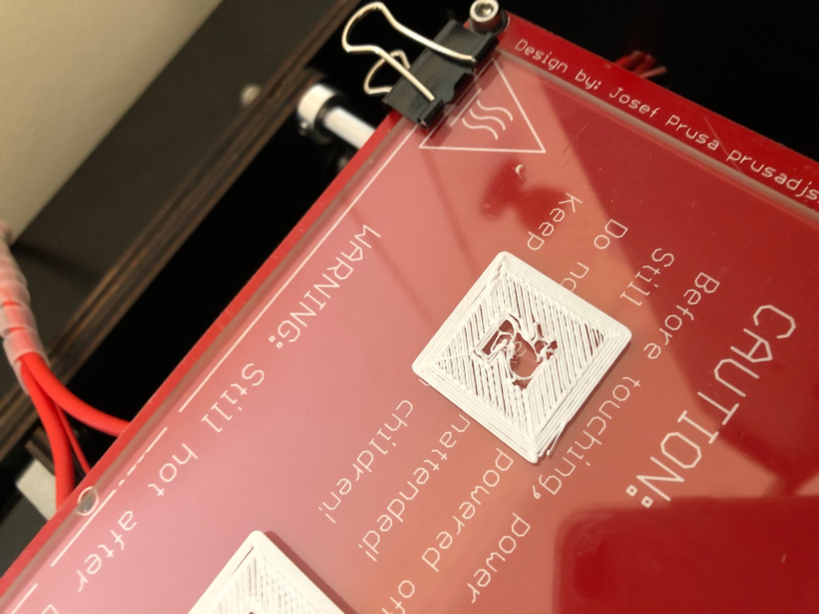

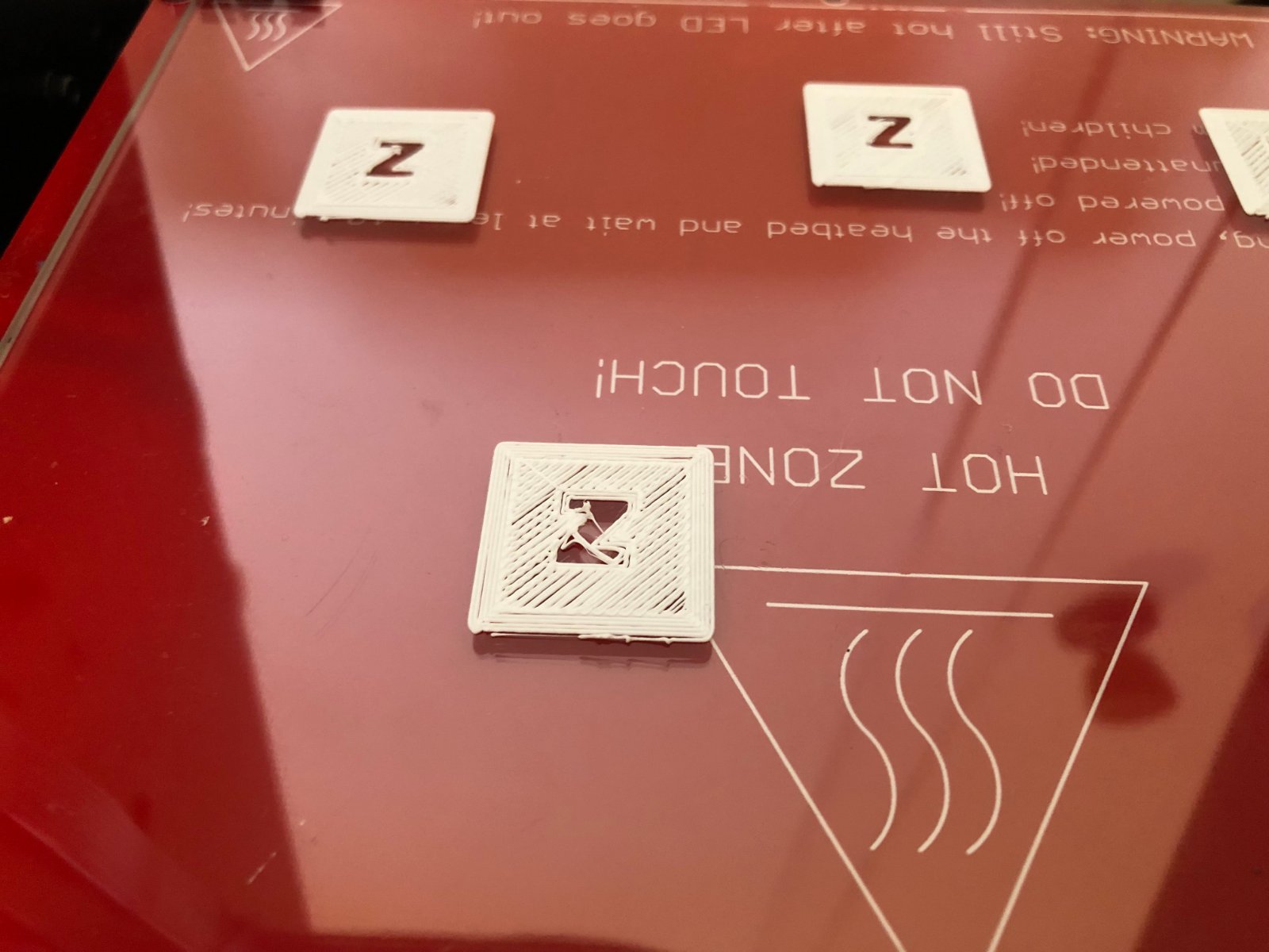

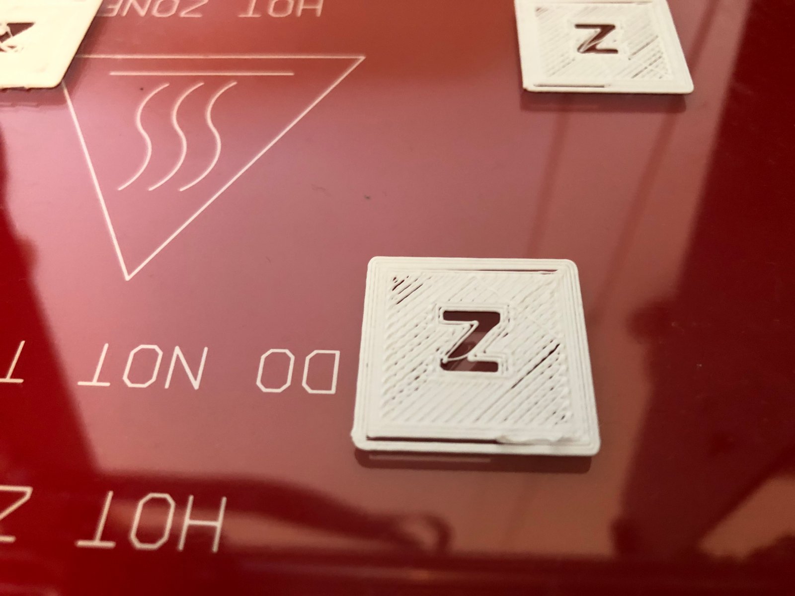

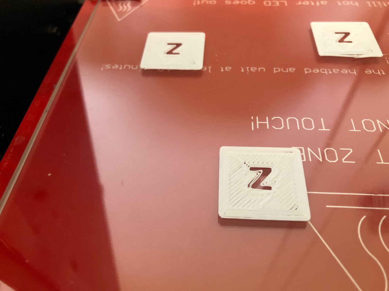

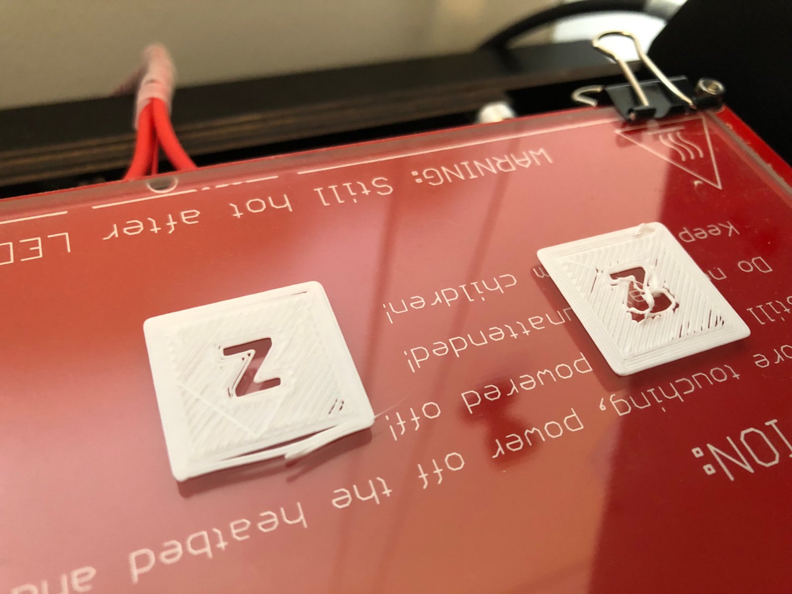

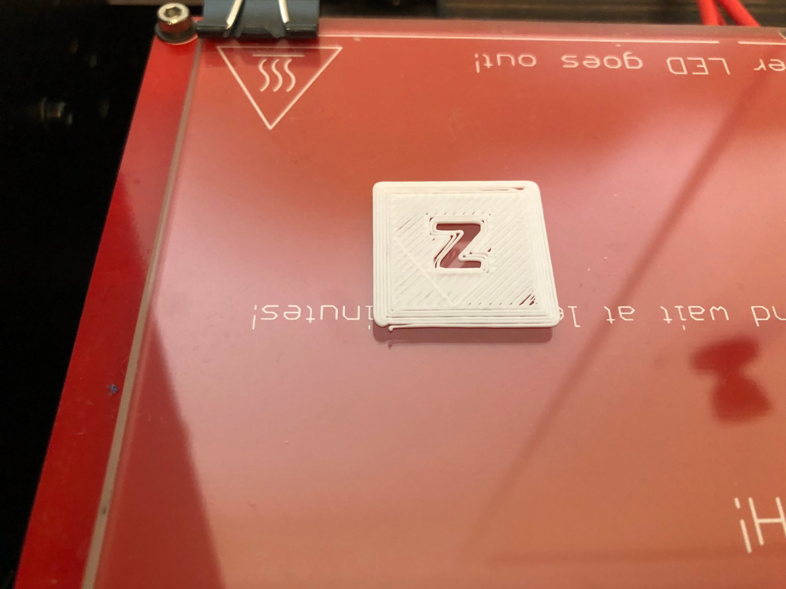

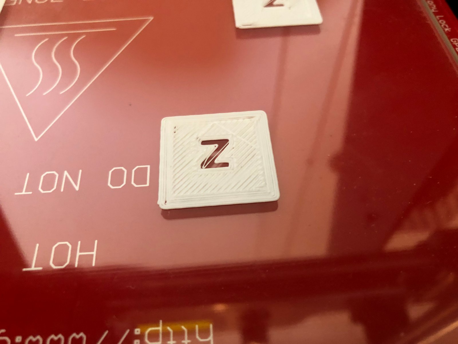

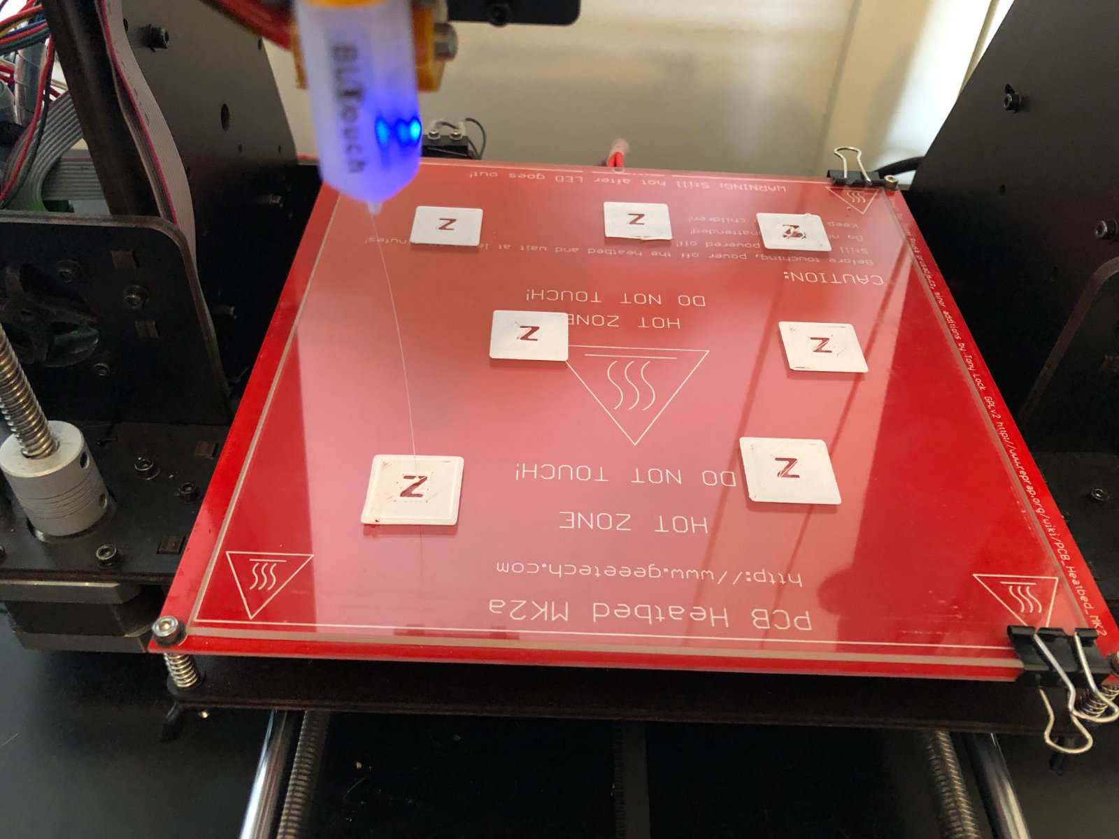

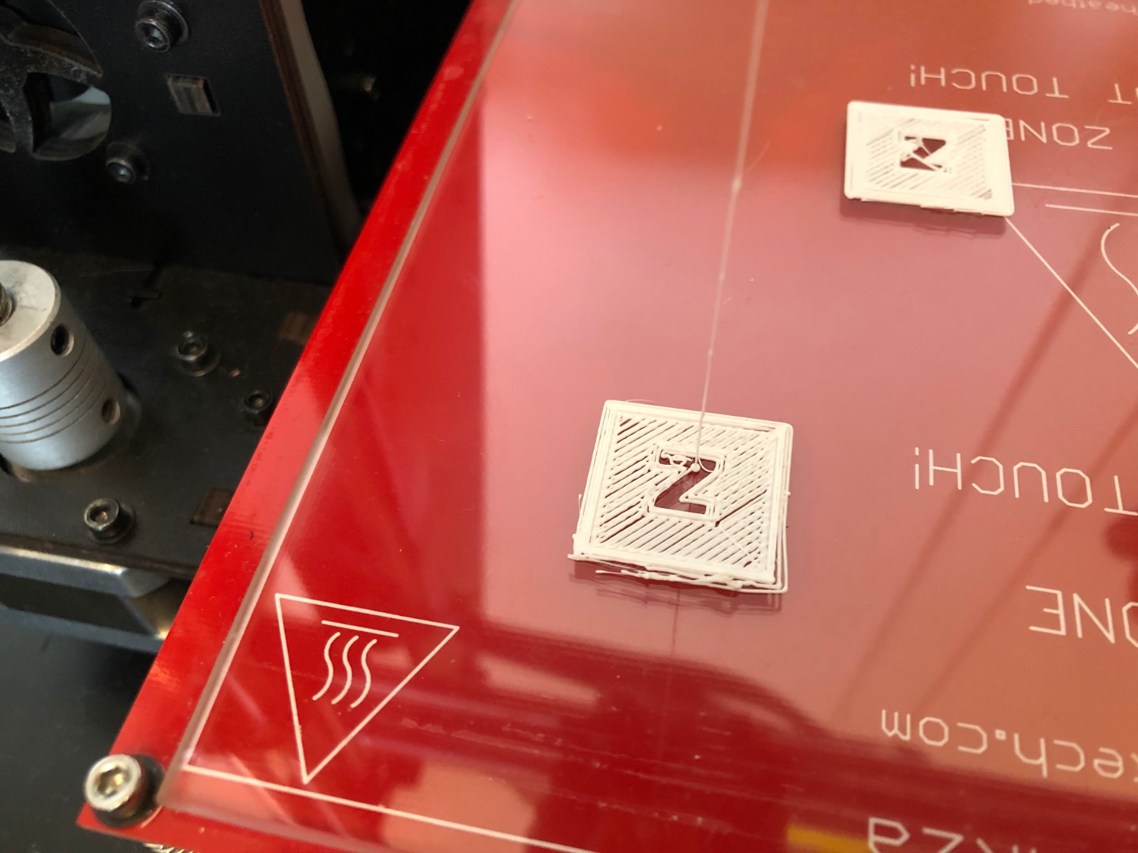

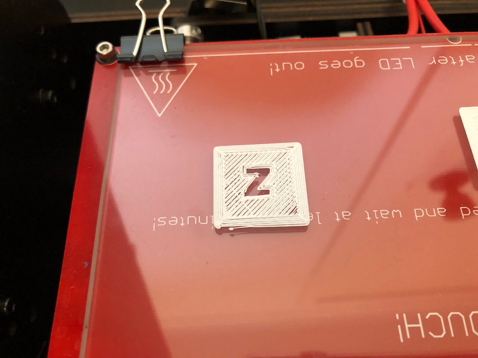

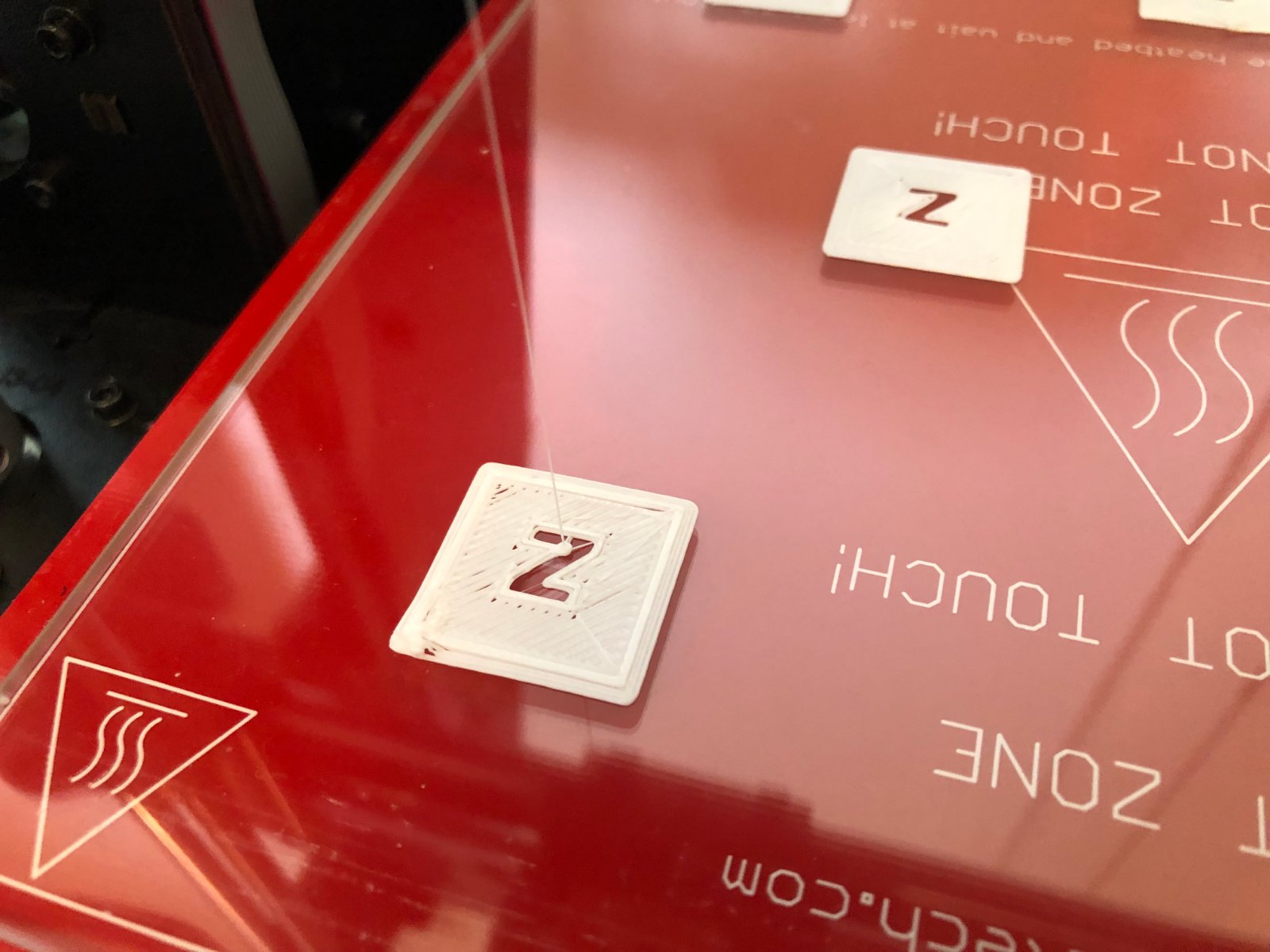

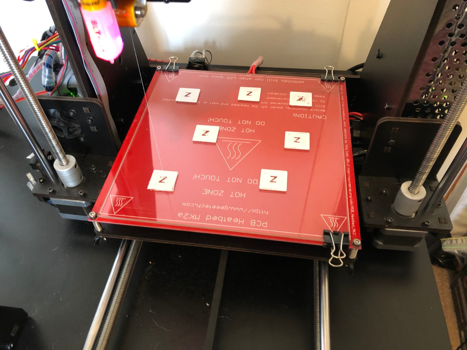

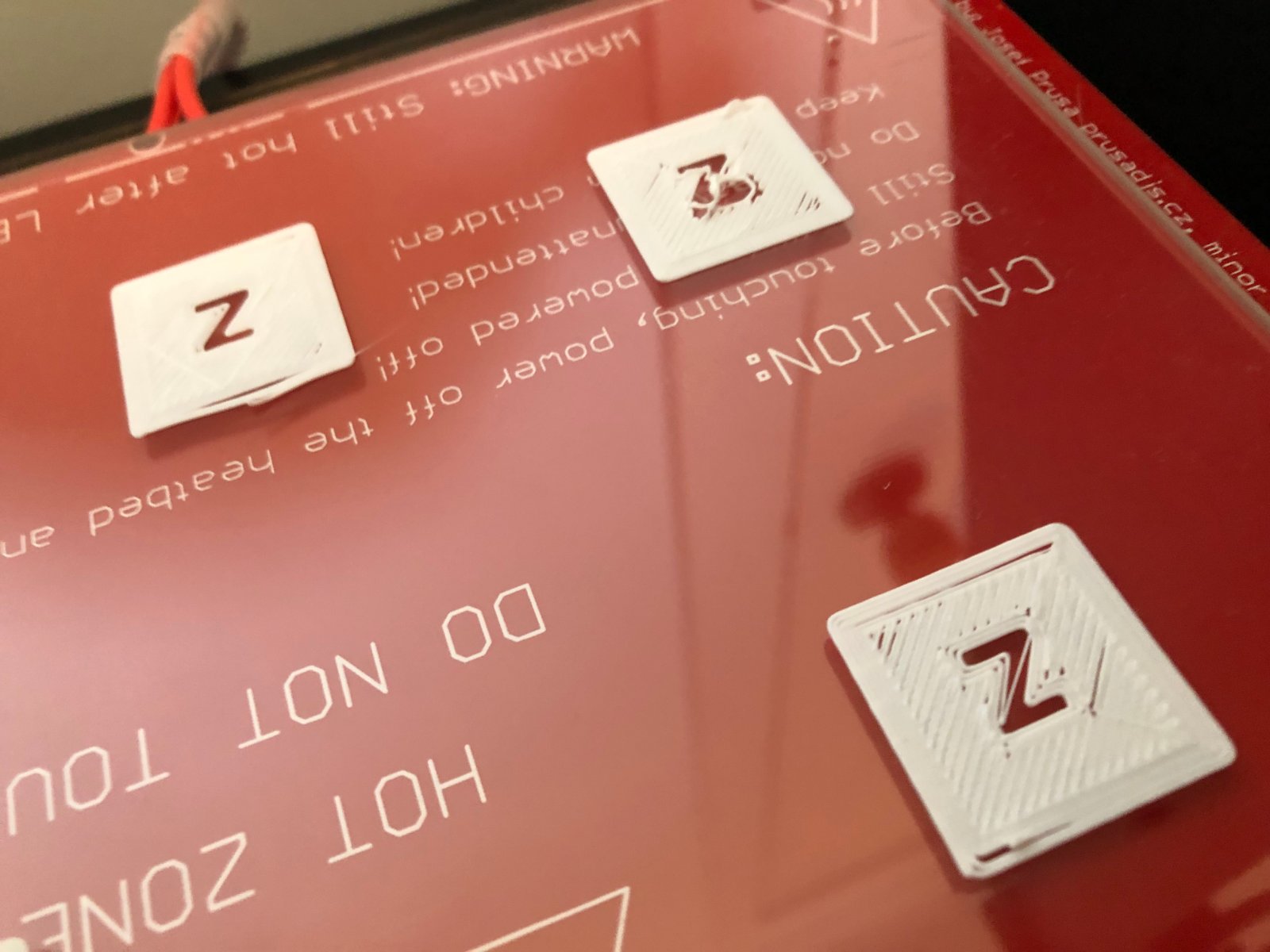

I flashed this firmware: viewtopic.php?f=20&t=60826 and commented out #define MIN_SOFTWARE_ENDSTOP_Z (thanks to advice from this comment: viewtopic.php?f=20&t=60826&start=10#p83238)
I think I might still have some issues with the jerk control, and initial layer flow, but it seems to be working perfectly, I've attached some photos of the first print.
Once I update the jerk control settings in the firmware, and get a I'll be uploading my version of the i3 Pro W firmware + BLTouch here, I'll also upload my Cura .ini as well.
I'll also work on getting the first layer really nice, I'll continue to upload my firmware and Cura .ini as I work out some of the imperfections, so keep a eye on this thread.
