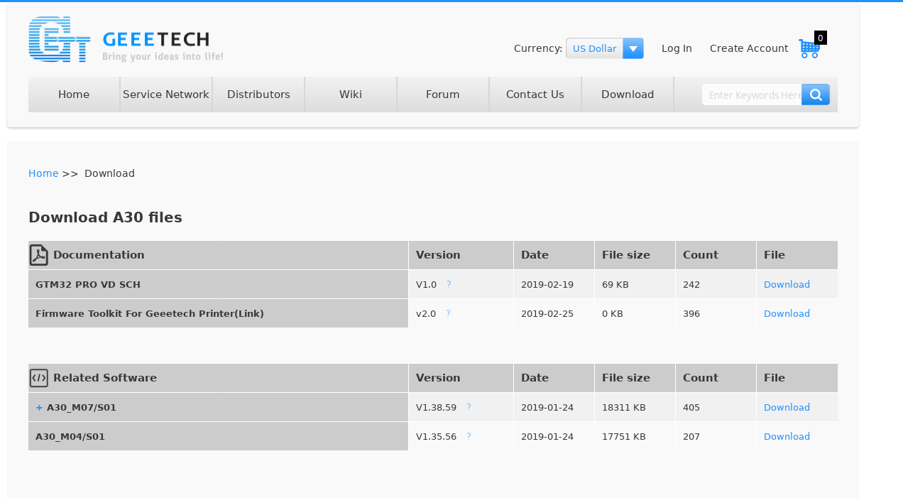

You downloaded these files from there:
Right
And after uploading the software, did you use the option to restore the default settings?
Right

Hey, yes, I tried two things. First I tried to use the firmware from the zip file of the toolkit. After that I tried to use the firmware showed on your screenshot but same problem with both versions.

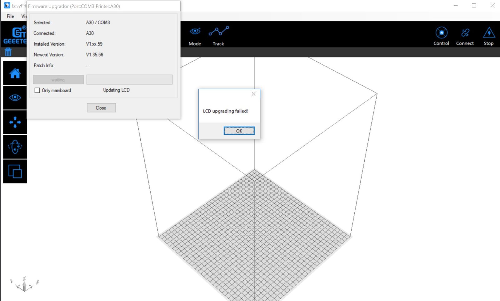

Okay, with the Firmware Tool I uploaded Version 1.35.56 but with this firmware the display keeps black. Anyway I also tried to download the Firmware via EasyPrint3d but there the timeout window appears while updating LCD. LCD keeps black.
