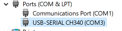

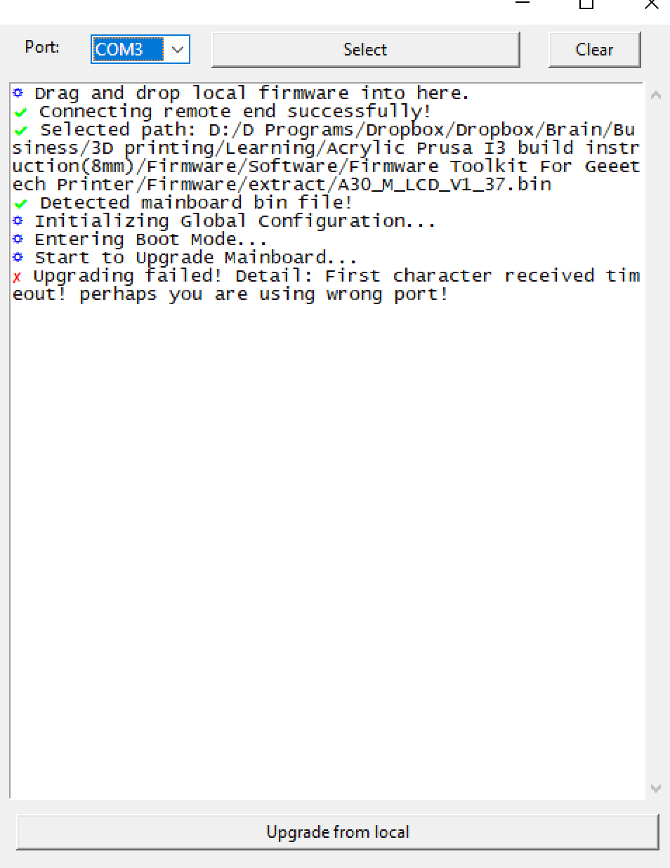

I would be grateful for any help on an error message I am getting inside "Smatto Firmware Upgrador V2.0"
I select the correct port being COM3 and then click select and choose the "A30_M_LCD_V1_36" however I get below error.
Error - Upgrading failed! Detail: the first character received timeout! perhaps you are using the wrong port?
I have installed the driver and it shows up under the driver manager called USB-SERIAL CH340 (COM3).
I am unsure how to proceed with any help or advice would be very much appreciated.

Hi.
The "TIMEOUT" error may also be due to incorrectly defined transmission speed or incorrect protocol parameters.

Hi Kaktus,_kaktus_ wrote: Sat Apr 06, 2019 1:37 pm Hi.
Thank you for pointing me the right direction, I literally have no idea haha
If I may ask how do I edit the protocol parameters would this be inside the files which contain code in the "Smatto Firmware Upgrador V2.0" folder"?
Can I also define transmission speed from within?

You can check the settings in the Smatto Firmware Upgrador V2.0 application to see if they match the parameters of your printer.
Don't do anything deeper, because you'll get into trouble.
I'm using Linux and I've never seen these applications. So my suggestions may be helpful but be careful.
