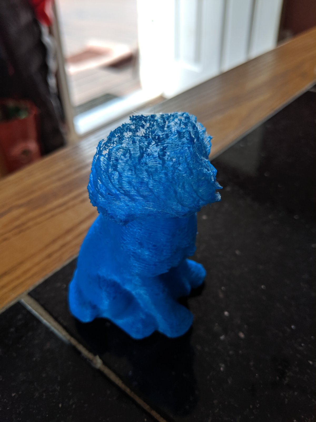

My dog began printing great but the head came out with not much material. Why did it change? Same file as everyone else.

- Head is honey comb
- MVIMG_20190605_162806.jpg (201.3 KiB) Viewed 24529 times
Re: Printing the dog (the one we find on the Sd card)
Hi, How much is your extruder steps set?
And maybe it is also possible that the nozzle is clogged, you can refer to this video for cleaning. http://www.geeetech.com/forum/viewtopic ... 15&t=68695
Would the quality change as it prints if it was extruder steps? What is a good step? New to this, so any idea is good.
Thanks
Thanks
Hi, the Extruder steps is 430
