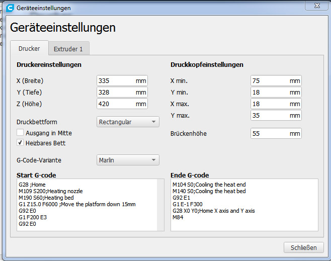

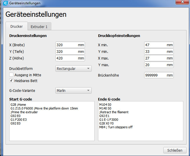

i have an error with the Geeetech A30 (with auto leveling sensor / Printing from SD-Card / Firmware V1.36.57 / Hardware V3.2).
The first print works very well, but if i try to send a second print behind without switching off the device in between, the A30 does the
Autoleveling, but instead of 3mm filament output and starting printing (the same file) again it comes to very fast constant filament spitting, till i swich it off...
Is this a normal behaviour for the geeetech, or something wrong in the gcode?
Video:
https://youtu.be/vpnVwDtHJHY
the same file with a restart of the printer (no problems)
https://youtu.be/x3q_08jFDBU
happens both with Cura 3.6.0 and gcode taken from the manual of Geeetech A30,
as well as with Cura 4.0.0 and profile downloaded from the Geeetech homepage (forum)
(why this Bedsize and fixed Temperature in Start-code???)
(sorry for my english; Best regards from Germany / Munich / Oktoberfest ;) )

The printer works with Cura with no problems, when i add G21 (to set the metric in mm) in the start code. (Printer is located in Germany ;) )
