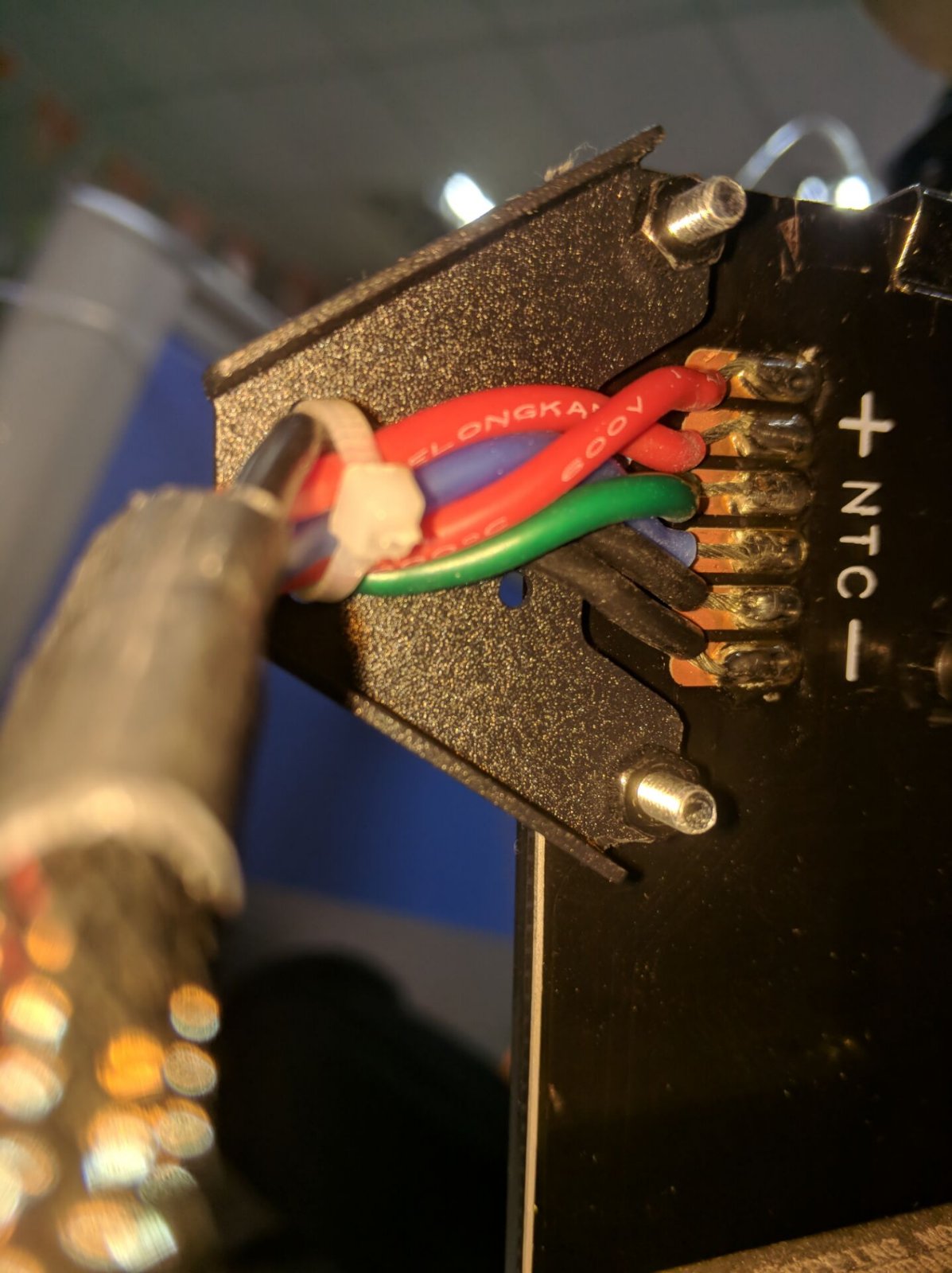

You can use the multimeter to check it.
The normal thermistor resistance should be 80~120KΩ
I don't have A30 but I have the A10 printer(The heatbed wires should be the same)
A10 Heatbed v2-1.jpg (198.61 KiB) Viewed 7402 times
The blue and green lines are for the NTC thermistor. :shock:
