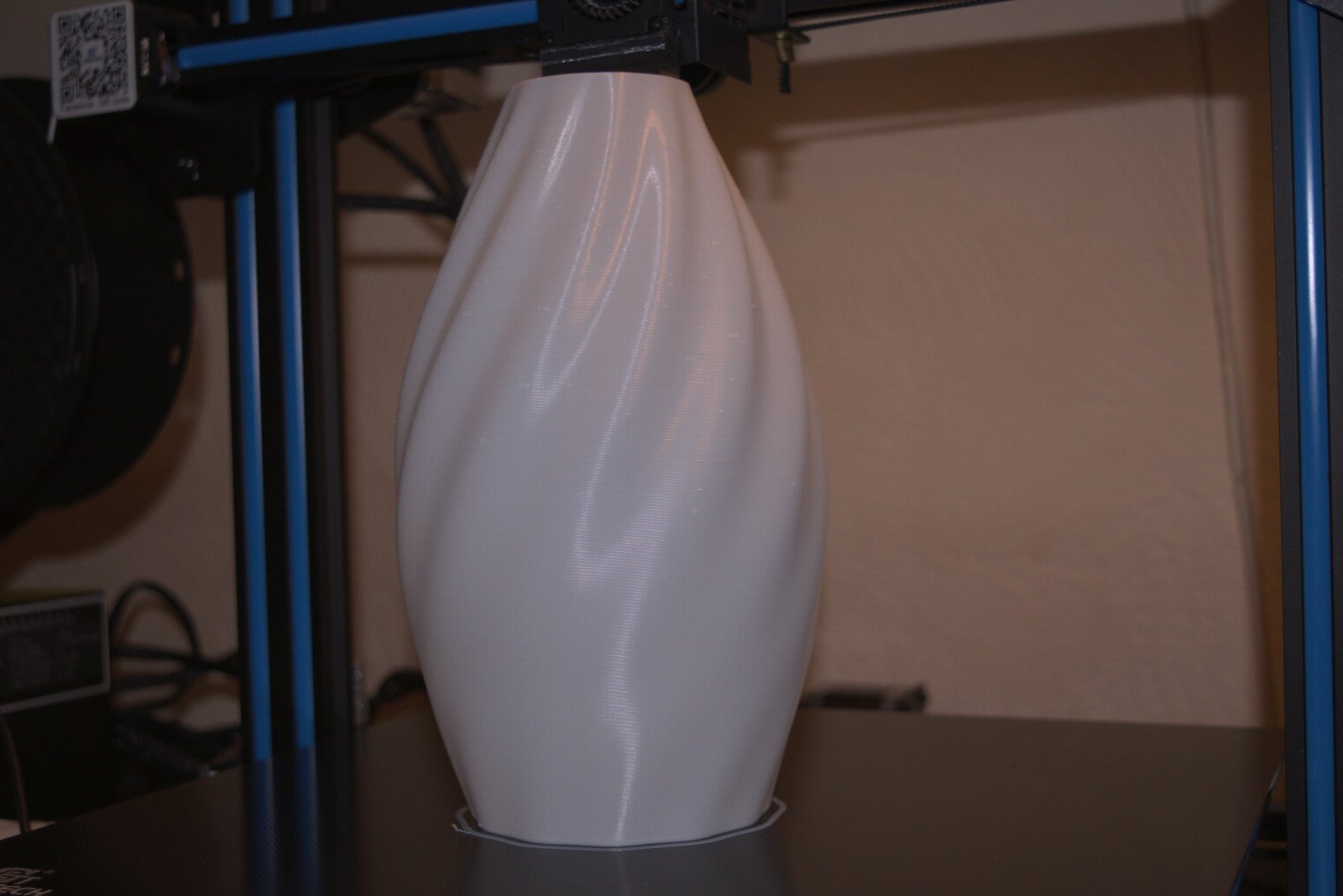

Mine seems a lot better after calibrating but I find I am getting pauses for a fraction of a second every now and then that is causing the spots on my prints, I will take a photo when finished printing maybe I am printing a little too fast for the buffer to keep up with, but not sure.

Here is a photo it is still printing but managed to get it focused to a point you can see the spots.

Are you printing from SDCard? I'm using a raspberry pi with OctoPrint, I strongly suggest getting one of those and installing it for a great web-interface and remote-control capabilities... also, I never encountered short breaks or anything alike printing with this setup. What speed are you printing at by default? Same as the profile you shared?

Also, that looks like a very good print, I can hardly notice anything bad on it on that photo :)

I am printing though USB my SD Card reader hasnt worked since day 1, I bought the Wifi module also to find my tablet isnt compatible lol software runs and connects to the printer but none of the operations do anything through it. I am using my gaming PC at the moment but have started using my Laptop to print recently as win 10 likes restarting at the most unwelcome times.
Yeah using the my Profile posted in my sig just changed a few parameters such as turn off top layer, turned on spiralize ect all speeds are the same though.
