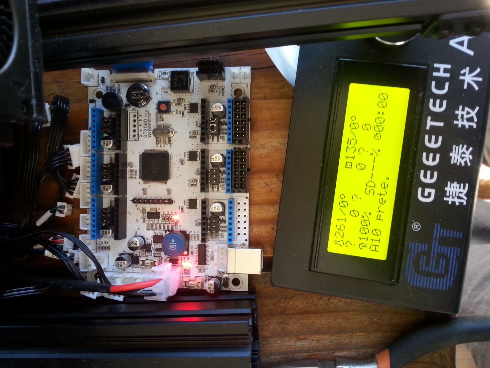

Re: problem of temperature sensor
I tried by unplugging everything from the motherboard and flaming the firmware.
Always the same problem. view the photo

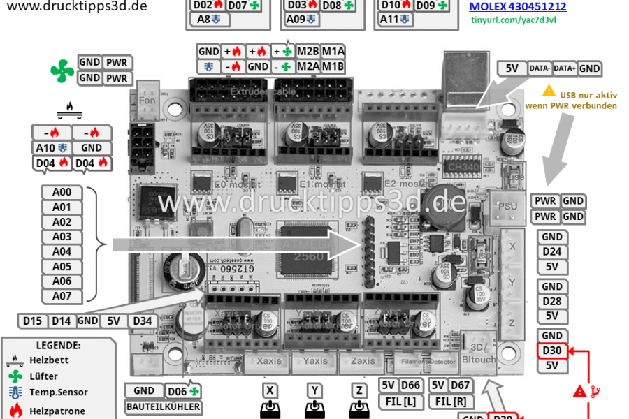

Hello,
I've got a similar problem with the printer.
The temperature of the extruder is always shown with 273°C, even when the printer is just turned on.
I have disconnected the connection cable between mainboard and extruder, nothing changes.
When I disconect the cabel to the heatbed, the temperature of the heatbed changes to -14°, so the sensor of the heatbed seems to be ok, also the cabling.
So I would like to know, where on the GT2560 V3 board are the connection pins for the extruder temperature sensor so that I can check the mainboard.
I've checked the mainboard using the pin-out information on the attached picture.
Without cable the extruder temperature is shown as 273°C.
If I connect the temperature pin with the ground then the temperature is shown up to 350°C.
I think that this is a proof that there is an error on the mainboard.
Or is there another possibility.
- GT2560_PinOutV3-900x600.png (481.97 KiB) Viewed 9895 times
