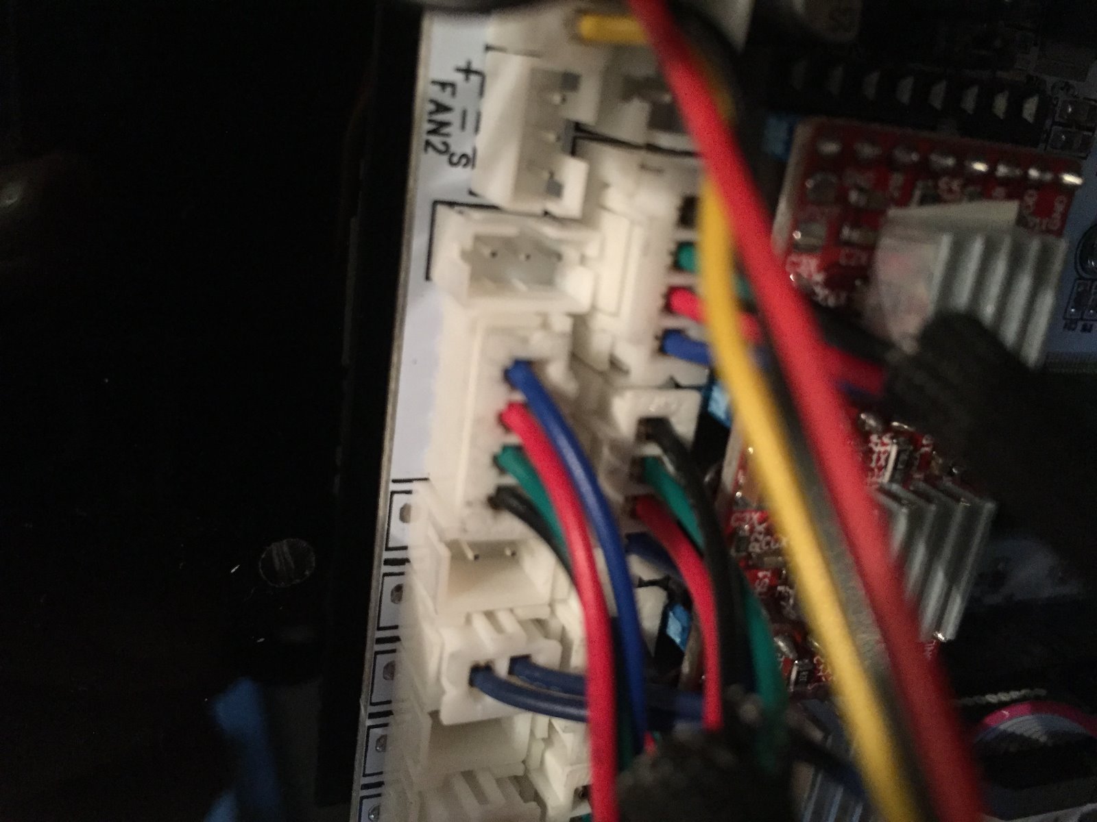

One thing I have noticed, the wiring order on my top z axis plug goes black, green, red and blue.
All the motor plugs below, plug in the opposite way, blue, red, green and black.
looking at other diagrams and photos, my top plug looks to be mounted upside down, could this be why I am experiencing the motors moving in opposite directions?
Picture attached:

Hi SamT,
I've looked at your photo and I think you're quite correct in thinking you have a reversed plug.
That would have thrown me off course with my build !
All my plugs have blue on the left. ( GT2560 A+ Board.)
You can see your supplier for a replacement... or do you think quicker to make up a plug/socket short lead to correct this ?
No, you're not going mad. It's not your error !

Hi.
Yes, it is an assembly error
To fix it, remove the plug.
Then gently but firmly pull the socket body. There will be only pins left in the PCB.
Then insert the body turned back 180 degrees.
Connect the plug.
Connect the plug.
