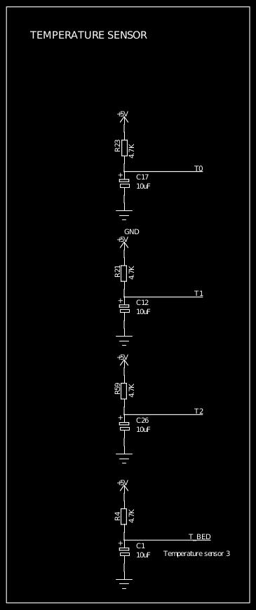

I've prepared a snippet from the schematic for you. So I put it here.
If you feel strong you can change the ADC µC input, and you don't need to solder a new chip.

thks for the solution, but since I managed to fry 2 boards....
...at the one board your solution might help, but on one board frying the chip did not only throw off the T0 readings but grounded T1, so I have a permanent -14°Celsius :)
Ah and nice that you are showing the shematics....
they are worng as well!
the mixed up the T0 and T2 number on the current PDF at their homepage.
You you will defenitly change the wrong capacitor if you use the shematics numbers....;)

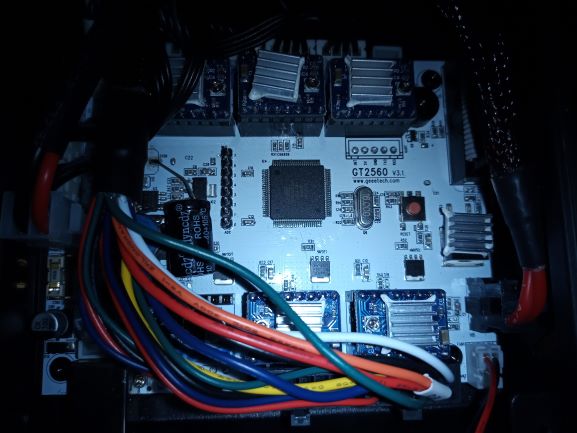

I changed the thermistor to hotend for NTC 3950, everything worked well, but now shows me the temperature hotend 98°C even if it is not warm. This temperature is shown even when the sensor connector is disconnected.
The input on the board is damaged. There is no possibility to access the thertermist to another location, e.g. extruder 2 or 3? I have a Geeetech A10M with GT2560 V 3.1
The printer is working, but sometimes tepmerature runaway error occurs when printing. This cannot be printed because the printer stops after the error.
