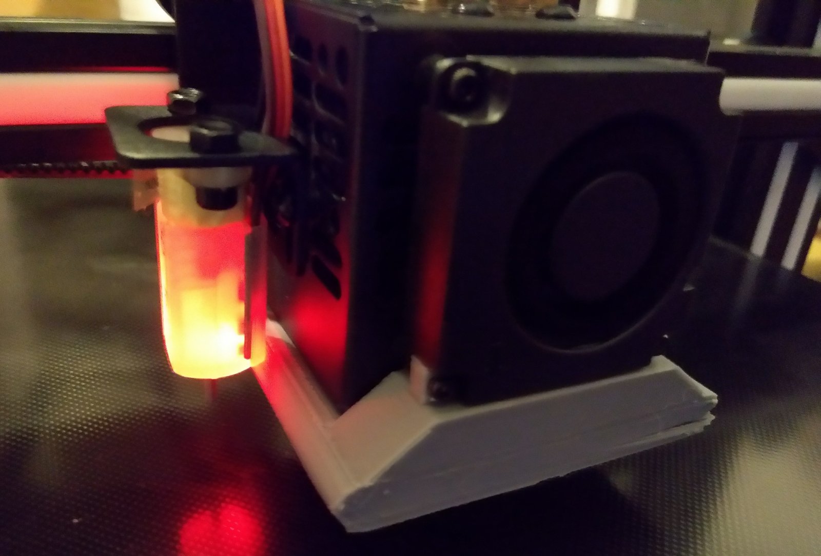

I installed the 3D Touch sensor in that way, that the needle will be higher than the nozzle in the high position.
Then I started go to home position. The home position will be above the hotbed. Therefore, go to move Z-Axis and move the nozzle to Z-Position = 0mm.
The nozzle will be above the hotbed. Now, you estimate or measure the distance to the hotbed and put this value as negative value into the Z-Offset.
Now, again Home Position. The Nozzle will stop above the hot bed. No, move again the Z-Axis to 0 in 1mm-Steps, out a sheet of paper on the hot bed. Either, z=0 is perfect or you have to fine tune the Z-Offset.
Don't forget to store the Z-Offset each time after changing.
That's all.
