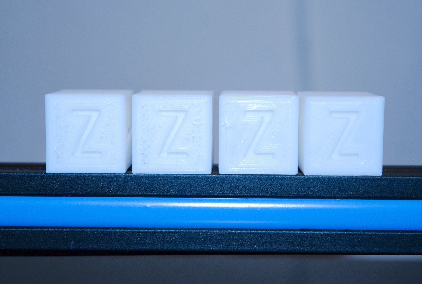

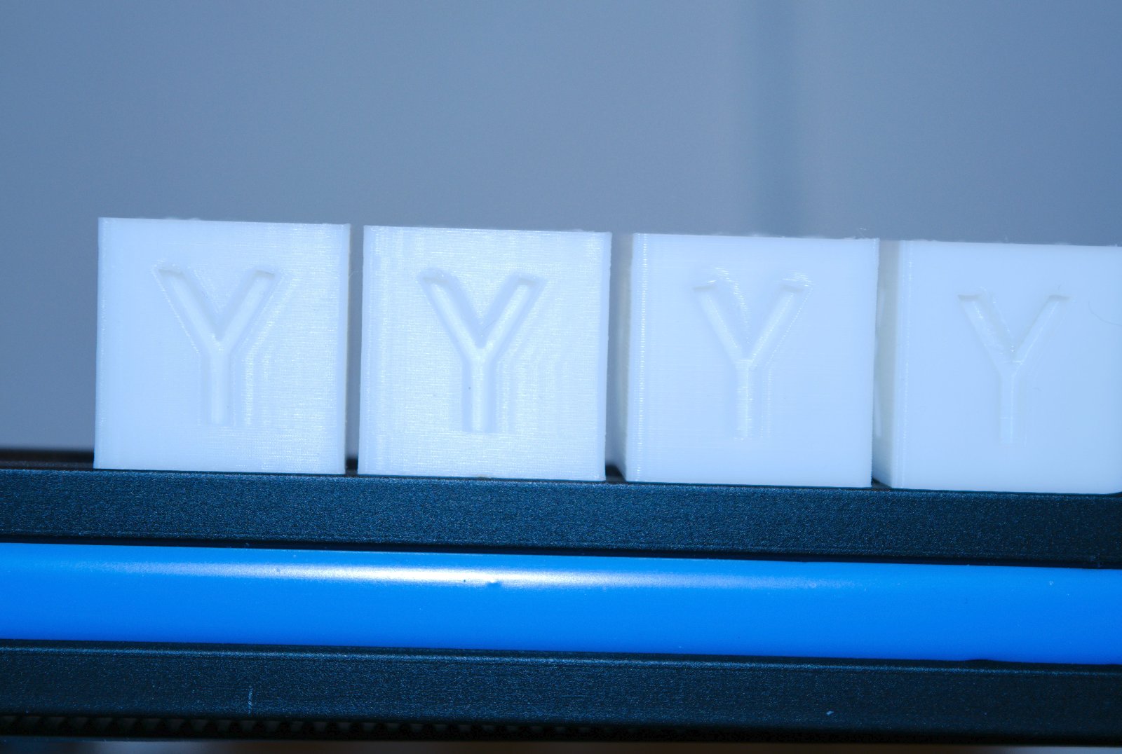

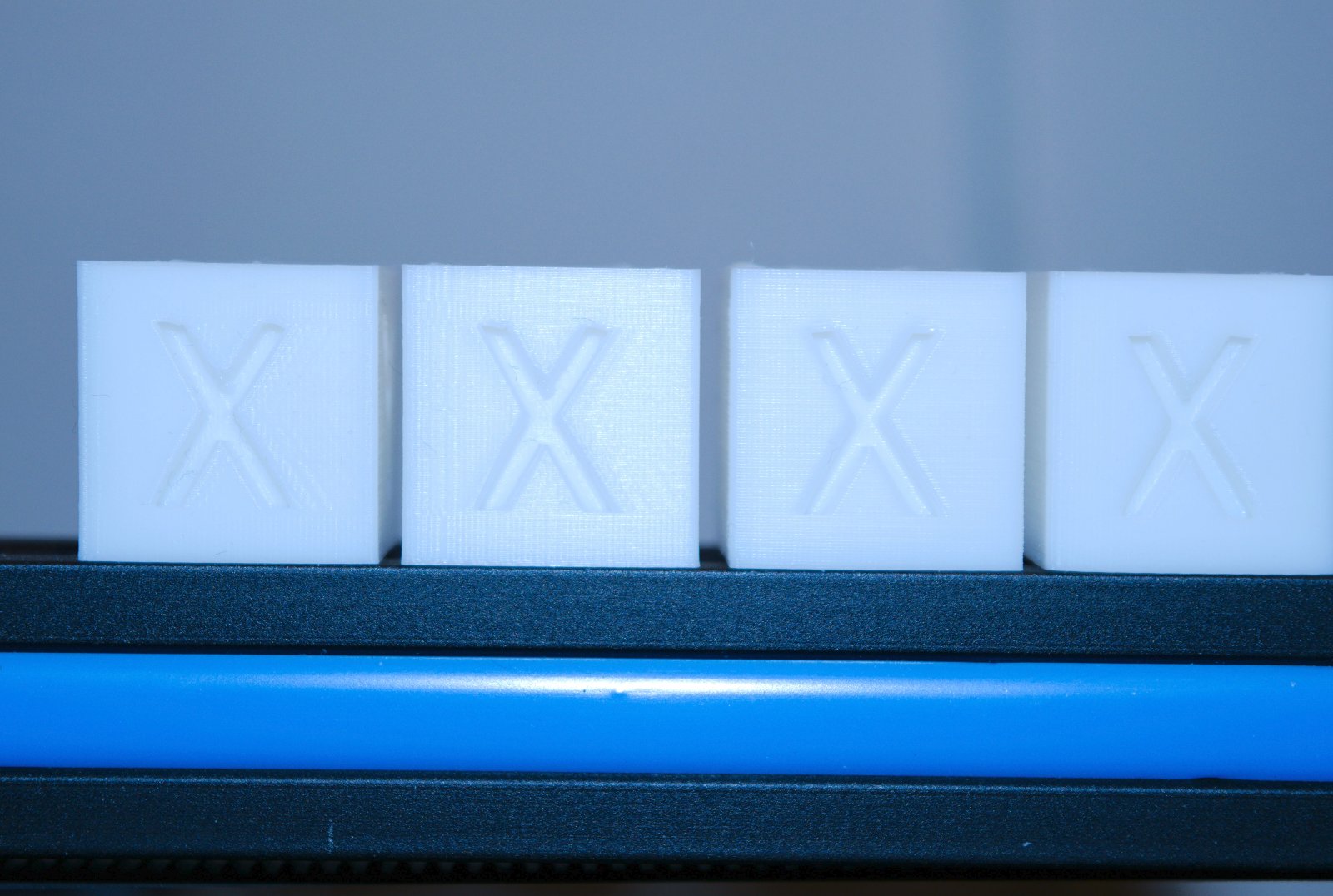

You also have to watch your Bed Leveling as the frame has no Center support only the four corner feet so when your leveling the bed and your hand rests against the frame your adding the wieght of your hand making the Z and X axis to lower slightly so your best bet is to slide the paper under the nozel after you take your hand away. I will try and make videos at what I mean if you dont understamd as I am not that great at explaining. But why they didnt put a center support foot on either side is beyond me as the weight is on the center of the frame and the profile is so long there will be a slight bowing in the center.
on my A10 I used the 3d touch to level the bed but found I ended up with scratches on the bed, So I do it manually on the A30 And as you will see in the photos when I post them My bed is scratch free. I have been using the A30 for about 8 weeks or so, Here are the photo's from the X and Y sides of the Cubes posted above looking at the pics showing in the link you posted I dont have the problems with the wavey Lines.

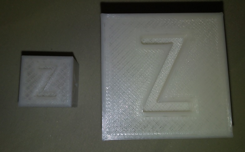

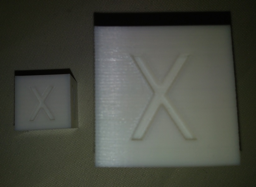

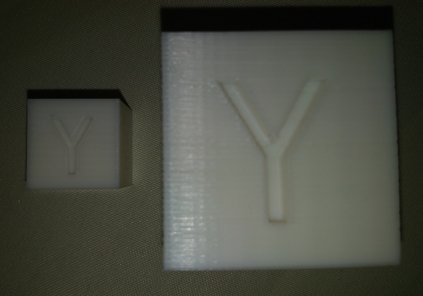

I've printed a default sized cube in the middle of the print bed in 0.1 and wow, best I ever got out of this printer so far! However, the issue really is bad when prints are larger, thus the closer to the border of the printable area, the worse the print becomes.
To check for this I scaled up a cube 200% and put him in the front left corner of the print space. I will probably do a confirmation print tomorrow with something larger and more complex, but the second test print also came out a lot better than ever before! It appears there is still some small ripple/waving on the Y-Axis, so I'll check the mechanical parts there again.
Sorry for the picture quality...

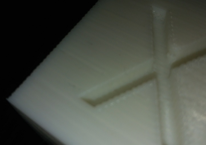

The ripple is pretty good visible here:

Did you use a larger layer height on the Larger Cube in the bottom pic?
It looks like Thick layer lines to me from the pic, I have scaled to 200% and placed it in the left front Ill try it now.
